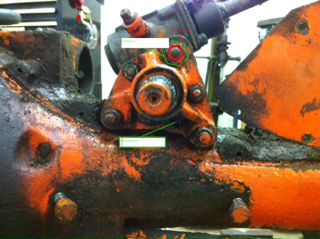

I have to differ with yall on adjusting the Gemmer on the tractor. Take a look at the pictures I took when I was repairing and adjusting one. You do have to get your eyes onto what you are doing as well as think your way thru what is happening inside the box after it is back on the tractor. You have to adjust the teeth for clearance at the outer teeth lock to lock and not just the center. You also have to adjust the clearance taking into accout the depth the teeth enter the screw.  You may have to assemble and disassemble more than once to get it in your mind  how far the teeth need to enter.
On a used steering box it is hard to find two that have the exact same ware that will adjust the same instructions.
On the bench so to speek is where you can turn things ever which but loose to see what is going on. Most of these Gemmer steering boxes have a good place where they will work smooth without extra play in the steering wheel.

Interesting! I did not think about the adjusting the single bolt with locking nut while adjusting the depth. Also, I had this thing apart so many times, I also missed the stud with the conical/tapered insert is also offset. I may get this thing to work after all. I will let you all know how it works out.

Figured it out, the top right stud that houses the tapered bushings is the "other eccentric". I might actually make some progress tonight! Thanks for the help, I would up load a picture, but the forum won't except pictures via iPhone.
