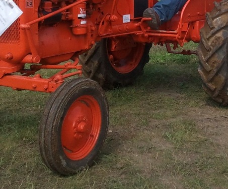

Let me begin by saying that I live on about 1/2 acre in a city of 250,000 so I don't have a NEED for a tractor, especially one that will work a field. That being said, I wanted to relive my youth so I bought a CA, which is what we had growing up. When I bought it, it was missing the drawbar. (Again, wasn't planning on using the tractor other than shows & parades, so it wasn't a big deal). But the longer I have it, the stronger my desire to have it "right". Let me be up front in saying that I have no idea what I need. I've looked through my manuals at the drawbar set-up, but I think I'm missing whatever the drawbar hooks to at the front. The picture in the manual isn't clear on the attachment to the tractor. I've attached a picture, so hopefully that helps. Any help would be greatly appreciated!

The CA had two types of drawbars.  One that was used with the pin hitch and one that was used with the snap coupler hitch.  It appears you may be missing the front part of the hitch.  A picture showing the tractor from the front view will probably confirm what is missing.
Could you supply a picture from the front of the tractor showing the linkage arrangement under the transmission housing so we can properly determine what - if anything - is missing.

Post Options Post Options   Thanks (0) Thanks(0)   Quote LincolnAllisCA Quote  Post ReplyReply Direct Link To This Post Posted: 19 Jul 2012 at 8:09pm
Thanks for the info. I noticed in the manual that the snap coupler came out in '54. Mine is a '52. Here is a picture from the front. Not sure if it's helpful. The tractor is actually at a show for the weekend. If I need to get another pic from underneath I can. Thanks again!

Post Options Post Options   Thanks (0) Thanks(0)   Quote Bill Long Quote  Post ReplyReply Direct Link To This Post Posted: 19 Jul 2012 at 8:18pm
That shows exactly what I suspected.  The linkage for the pin type - traction booster hitch - is missing.  I cannot understand why it was removed.  This linkage or hitch is the point the drawbar, plow, and other implements is attached to.  It also provides through a spring loaded hitch and linkage to the hyd the traction booster system.
Perhaps one who has a CA can provide a similar view so you can see what is missing on your unit.
Are there any other parts or linkages around?  It may have been removed and stored nearby.

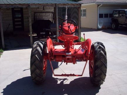

Post Options Post Options   Thanks (0) Thanks(0)   Quote Dakota Dave Quote  Post ReplyReply Direct Link To This Post Posted: 19 Jul 2012 at 8:30pm
first picture is back end. lift arms drop straight down and rams pin inplace.a cross bar pins between the arms to support the back of drawbar.
front looks like this part hanging down behind the woods bracket. The loader brackets get in the way to get a very good picture.

Post Options Post Options   Thanks (0) Thanks(0)   Quote Nathan (SD) Quote  Post ReplyReply Direct Link To This Post Posted: 20 Jul 2012 at 12:25am
You can put a u-shaped hitch from a C on a CA. Not totally correct but much better than what you got.

Post Options Post Options   Thanks (0) Thanks(0)   Quote Gary Quote  Post ReplyReply Direct Link To This Post Posted: 20 Jul 2012 at 4:36am
I agree with Nathan.
If you simply want a Drawbar you could instal one from a Model 'C'.
Probably a lot easier to come by.  See picture attached.
