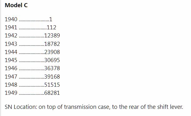

Brand new to the site. Life long Allis fan. Just brought home a C with a side mower attachment. Looking for the serial, I think I found it. From what I can tell it is 64981A…. Does this sound correct and if so, what year is it. I’m thinking a 47 but don’t know for sure. Thanks for any info!

Post Options Post Options   Thanks (0) Thanks(0)   Quote steve(ill) Quote  Post ReplyReply Direct Link To This Post Posted: 17 Mar 2024 at 5:29pm
should start with a C... and several digits... no "A" on the end...

Post Options Post Options   Thanks (0) Thanks(0)   Quote john2189 Quote  Post ReplyReply Direct Link To This Post Posted: 17 Mar 2024 at 5:30pm
Serial number is stamped on a flat spot on the transmission right in front of the shifter. Should start with a C

Post Options Post Options   Thanks (0) Thanks(0)   Quote steve(ill) Quote  Post ReplyReply Direct Link To This Post Posted: 17 Mar 2024 at 5:32pm
64981A ---------- could that be C49814  ???  ..... just thinking how to get a C and no A..

Post Options Post Options   Thanks (0) Thanks(0)   Quote JeMa Farms Quote  Post ReplyReply Direct Link To This Post Posted: 20 Mar 2024 at 7:18pm
Think I found it.
C6741
Now, from what I can find, it’s a 1941, possibly 1942. Any opinions?

Post Options Post Options   Thanks (0) Thanks(0)   Quote JeMa Farms Quote  Post ReplyReply Direct Link To This Post Posted: 20 Mar 2024 at 7:20pm
Don’t know what happened there. Think I found it.
C6741
Thinking a 1941 or early 1942.

Post Options Post Options   Thanks (0) Thanks(0)   Quote steve(ill) Quote  Post ReplyReply Direct Link To This Post Posted: 20 Mar 2024 at 7:37pm
12,000 built in 1941... Yours was one of them.. Listed should be the STARTING number for the year.
