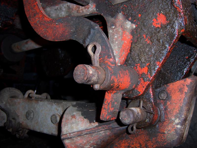

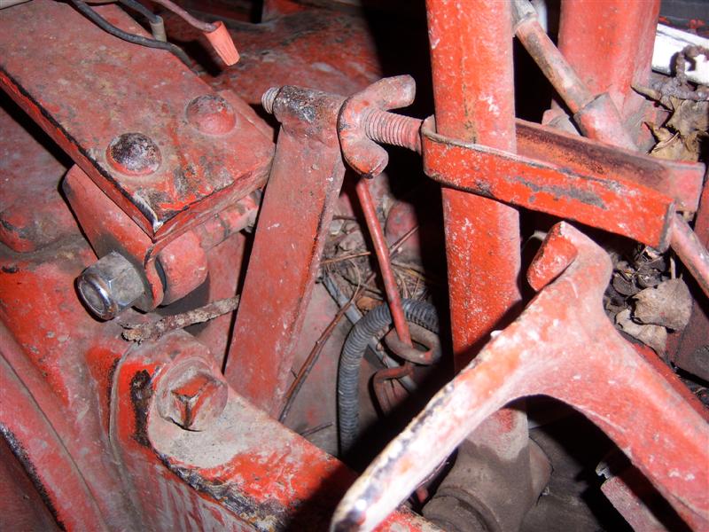

I hope the pics come through...
Has anyone tried to make one of these?  Where and on what does the bar pivot on?  You can tell the workings of the rest of it, but where is the pivot point? Is this a plate that is on all WD's and 45's?  Or is it an add on?

It pivots on the top pin in the first picture.  When the plow hits something the snap coupler bell gets pulled backwards.  The bottom pin in the picture hits the small plate, pivots the fork at the top forward and kicks out the hand clutch.

My WD has that setup on it and it works if set up right. I see the kickout bar in your pic has been welded at some time in it's life.
