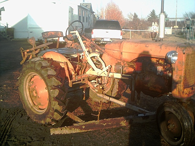

I never heard of a back blade just for the B without a three point. I have seen pictures of a belly blade for grading drives mounted under a B that were home built that really looked good.
Points: 89156
Post Options Post Options   Thanks (0) Thanks(0)   Quote steve(ill) Quote  Post ReplyReply Direct Link To This Post Posted: 21 Feb 2015 at 3:10pm
Points: 89156
Post Options Post Options   Thanks (0) Thanks(0)   Quote steve(ill) Quote  Post ReplyReply Direct Link To This Post Posted: 21 Feb 2015 at 3:11pm
the above was made out of a plow beam. If you have a rock shaft and cylinder, you could do similar. I bought the tractor with the beam and blade already on... it wobbled all over. I added the 2 inch pipe brace to one side. It slides and pins to adjust the left- right angle.......... I guess you could start from scratch and pin a 3 inch pipe or c-channel under the transmission area that stuck back 5 ft, to a blade / plate.

If you want to use for grading a belly mounted blade works so much better than a rear mounted. I've built a couple for C s and still have one. Just run a push bar foward from each plow point or else from the draw bar wel one side to a grader blade and make a pivot for the other side. A couple cables pulleys and hand levers and your in business. I'll try and find a picture of one mounted.

the above was made out of a plow beam. If you have a rock shaft and cylinder, you could do similar...
I have a B plow that is manual lift for my 39 B without hydraulics. I think you could build a manual lift blade from a plow frame.
