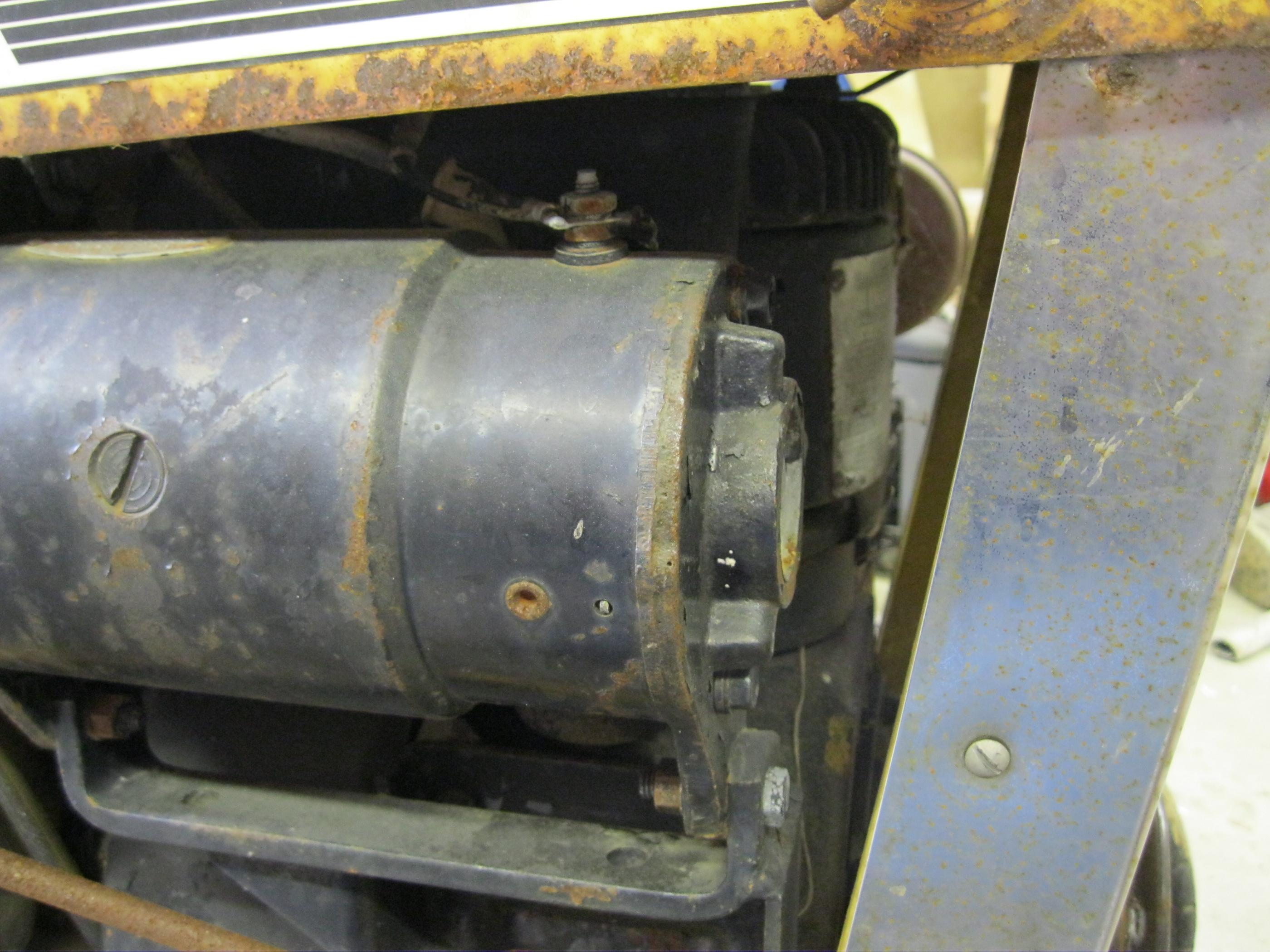

Sounds like someone changed something. All original generators fit with pulley end on outside of mounting bracket tab and other end on inside. B110's and up have different mounting bracket and both generator tabs fit on outside of bracket. Attached is picture of one our B10's.

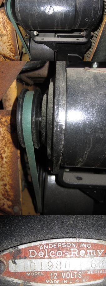

Sorry it took so long, been rather busy. Here is a picture of mine, looks the same as above.

The one that came with it is Delco 1101974, which looks like only a genset.  I guess I need to get the correct Delco number and find the correct one.  Anyone got one?
farmtoybuilder View Drop Down
Location: Dresden,Ohio
Points: 1457
Post Options Post Options   Thanks (0) Thanks(0)   Quote farmtoybuilder Quote  Post ReplyReply Direct Link To This Post Posted: 14 Nov 2014 at 2:25pm
Sorry I should have listed the number! 1101980 is on B10s,12's and the 1101689 is used on B110's and 1112's. Either one will work!
