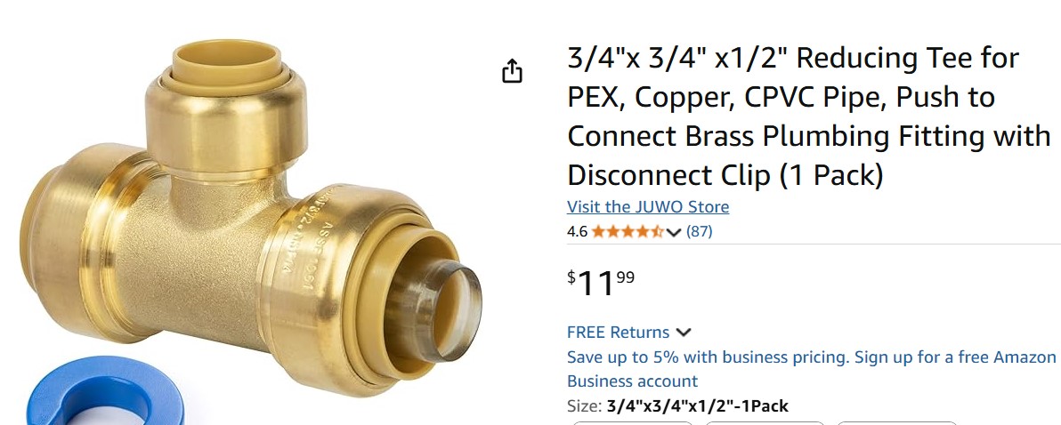

into PEX(3/4”), with cpvc. I don’t have a pex crimper, or any pex tools for that matter. Never worked with pex before. This will be a hot water extension from bathroom supply to laundry room. Or, would I be better off using pex, and getting the crimping tool, and stuff. The pex in the home is the blue(cold) and red(hot) TIA.

Shark bite fitting will easily connect the 2 . Be sure and use the plastic insert that comes with the fitting on the pex side . You don't need it on the cpvc side.

forget the CPVC... nothing but problems when it get OLD and BRITTLE, or froze... the PEX works great... I have a crimper and go that route.. Have used a couple shark bits and they are easy..
