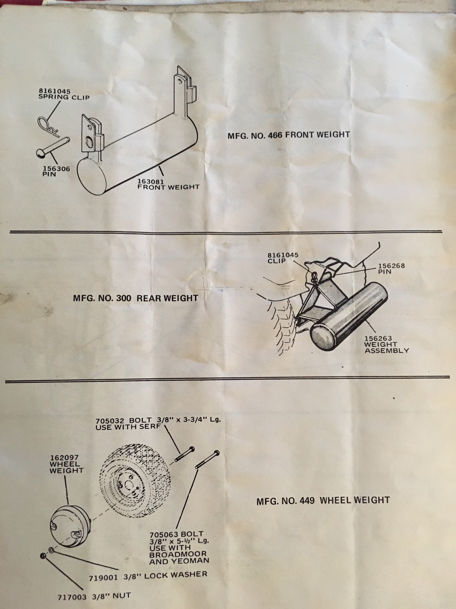

Welcome strengthchain,welcome to the addictions as of yesterday I am up to 14 B series lawn/garden tractors.Pick up a boat load information too.As I was reviewing it I found this section,it was offered by simplicity. I think it could be easily fabricated. were are in Pa located?uploads/18658/IMG_1159.JPG

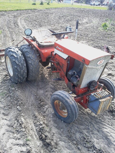

Post Options Post Options   Thanks (0) Thanks(0)   Quote HudCo Quote  Post ReplyReply Direct Link To This Post Posted: 27 Apr 2019 at 9:43pm
this is my front wieght and it needs it with rear equipment

Post Options Post Options   Thanks (0) Thanks(0)   Quote Animal Cracker Quote  Post ReplyReply Direct Link To This Post Posted: 28 Apr 2019 at 5:48am
Thats an impressive looking unit. Would you share some details. Me like

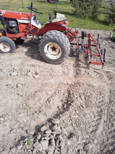

Post Options Post Options   Thanks (0) Thanks(0)   Quote HudCo Quote  Post ReplyReply Direct Link To This Post Posted: 08 May 2019 at 10:12am
it has a model 32 briggs 16hp. in it that was an excellant move.  i use all 16     i have all the 10 hp and starer gen. there was nothing wrong with it and is all to gether with wire harnass voltage reg . for some one in need.      i have the tiller  thats only thing that i drop the cat. 0 three point hitch off for  , have snowthrower , front blade the wore ou wheeler tires really work good but they will be replaced with 14x7 carlisle farm specailist and will probley get rid of the duals. will go to 9 inch pulley with the new tires.    the tri ribs in the dirt turn real well have many cat. 0 implements , it also has center lift arms for mower deck  and grader blade , i am going to use the belt drive on the flywheel for a hyd pump were the starter gen used to be and add a hi lo to it.
