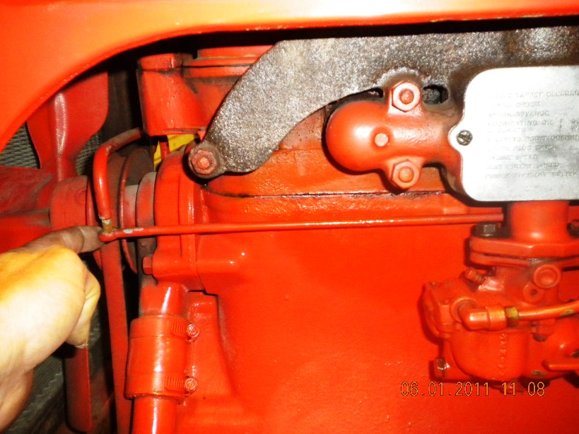

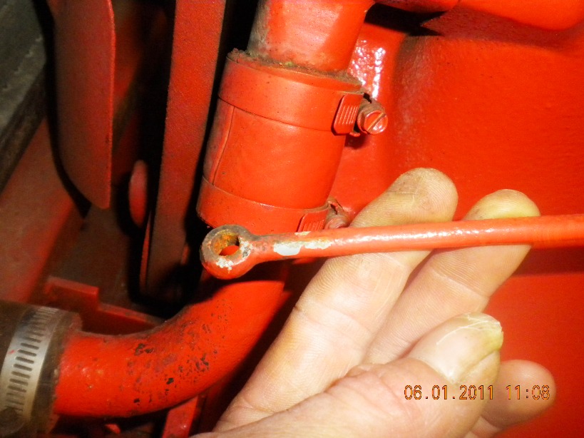

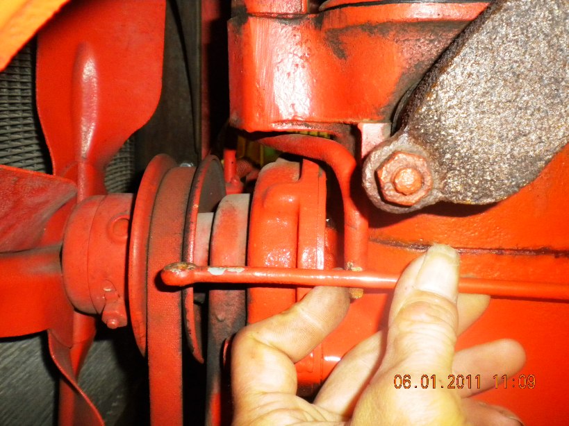

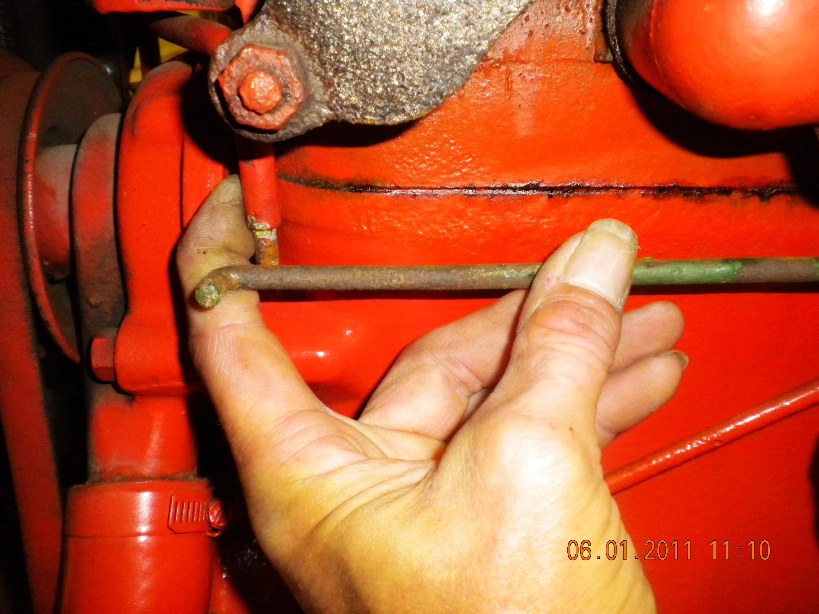

Ok, My 1938 B didn't have any throttle. You had to have the throttle lever at 7/8 of the way forward to get the engine to speed up a bit. So i found this topic and read it and tried Dick L's set up. I am not sure but think something right here. I took pictures and will post them along with a small write up about each and maybe someone can tell me if I'm doing it wrong or somethings wrong. I also found a rod in the box of extra parts which as you will see at the end might be the correct rod.

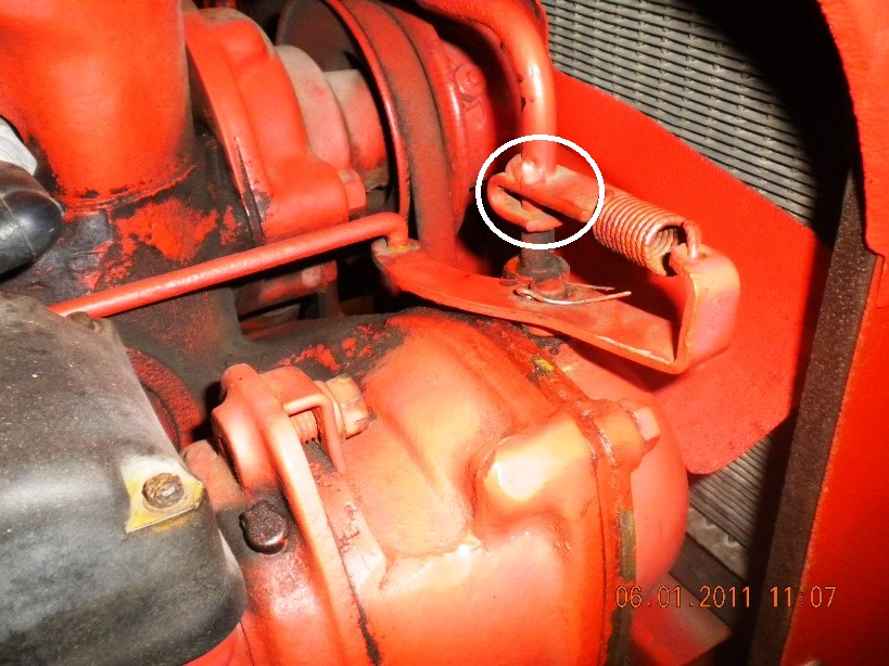

Here's a picture of the governor and the connections and rods. The throttle lever is all the way back at idle.
Here's the carb side rods and connections as i got it. The throttle lever is still full back at idle.
Here's the rod coming from the carb to connect to the governor cross arm. I took this picture to show the end.
Here's the gap i got using Dick L's set up. With Throttle lever full back at idle and the carb rod at idle (against the stop screw) I can feel some resistance on the cross arm when putting it back this far.

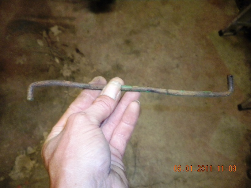

This is the rod that was in the box of extra parts.
If i put this rod to the carb and hold the cross arm back it looks like it's the rod for here. But the the would connect to the cross arm ain't right.
With all this shown and wrote, How far back do you pull the cross arm? I tried doing the wide open too but on the governor side it the plate that pivots (the pcs that the throttle rod connects to on one end and the  spring connects to on the other end) it hits on the cross arm. I hope someone can help me out.

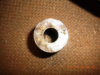

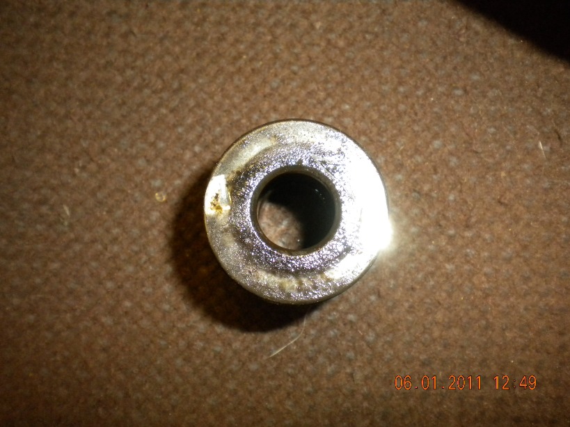

Dick,

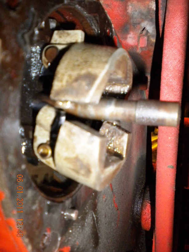

Here's the governor shaft and weights. The weights move freely and are connected.
Here's the inside of the cover. The forks are welded to the cross arm.

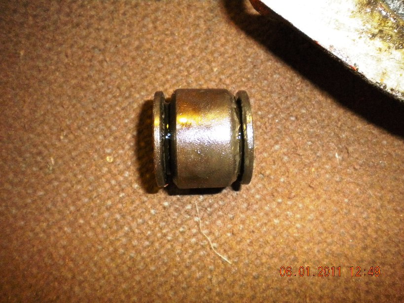

Here's the bearing. This is the side that towards the weights.

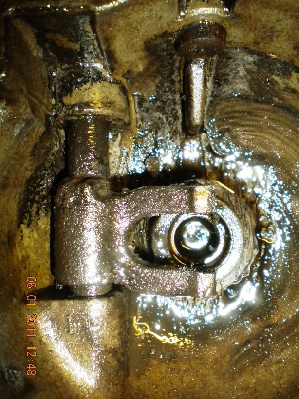

Here's the bearing fork side.
Here's the side view of the bearing. The side that the forks act on moves in and out and spins. The weight end doesn't move or spin.

All together and what little throttle there is is snappy. What i see now after talking to you is this. When the throttle is at idle all the way back, the spring that pulls on the cross over arm is very lose. As you slide the throttle lever forward, it doesn't pull on the cross over arm till about a bit after 3/4 forward. After looking at a few pictures and then at mine, Someone welded the spring hook to the cross over arm and i don't think they welded it at the correct angle. I think if it was turned a bit more towards the front of the tractor then the throttle would make it pull on the cross arm. In the picture i circled the part that is welded in white. Am i wrong, but what i see these parts and a clamp type fit onto the cross over arm.

There are two rods available for the early governor. One is for an engine with a generator and is quite a bit longer (11 3/4" vs 10 1/2") than the one for a non-electric tractor.
Check the AGCO parts book online (page 74  for the early Governor) and you will see the links called out for the early set up. The book also specifies the lengths, you can measure yours and compare to make sure someone did not inadvertently use the wrong part......
Edited by GlenninPA - 01 Jun 2011 at 1:53pm

Post Options Post Options   Thanks (0) Thanks(0)   Quote Dick L Quote  Post ReplyReply Direct Link To This Post Posted: 01 Jun 2011 at 2:37pm
Loosen the setscrew up by your hand throttle at the steering wheel and pull the rod up until the spring is tight but not to where it changes the idle. You can work it back and forth to get it right.
Might have shoulda maybe said push until you have the spring tight. Sittin ana thinkin seems not ta be my best thing ta do but after posting to pull my thinker started to see the bow in the rod when I reach for the high dollar RPM's.
Fiddle with it and you'll figure it out. That is where you take the slack out of the spring anywho.

ANyone know how to make a B idle smooth? I rebuilt the motor and it runs good, but the gov wont quit hunting. Anti surge spring is installed, gov adjusted for preload per I&T service manual, new condenser, coil in mag, points filed and set to proper gab. carb cleaned out with fresh gas. I need to check the gas cap vent but after that I am stuck. I am going to try to post a vid in the next couple of days.
Hey Don, did you ever get this issue resolved?  I just rebuilt the carburetor and adjusted the cross shaft arm and now it surges bad.  Just wondering what you may have found out.
DonDittmar View Drop Down
Location: MIllersburg, MI
Points: 2517
Post Options Post Options   Thanks (0) Thanks(0)   Quote DonDittmar Quote  Post ReplyReply Direct Link To This Post Posted: 25 Feb 2013 at 11:26am
Originally posted by Dean (West MI) Dean (West MI) wrote:
Well yes and no. I was rebuilding/painting for a customer and it wasnt my tractor.  I did narrow it to the carb, and no matter what I did I could not make it stop the surging. I had that thing apart 3 times and could make any difference. My customer elected to run it as is so I returned the tractor to him.
It would only surge at idle, under a load it would not miss a beat. I told him I would by a carb and put on it and if I ever figured out/fixed his orginal one we could just swap them out and I would charged him for whatever was needed to fix the orginal. He said he would just replace it himself when he got the funds.
1968 D15D,1962 D19D
Points: 2517
Post Options Post Options   Thanks (0) Thanks(0)   Quote DonDittmar Quote  Post ReplyReply Direct Link To This Post Posted: 25 Feb 2013 at 11:27am
You have to remeber that if there is something wrong with the carb that would make the engine drop in RPM, the governor is going to constanly try to counter-act that
