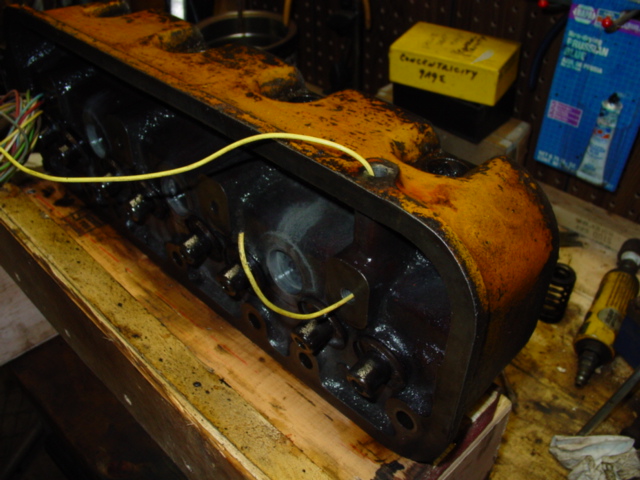

    Hey Dick L,,,,since you mentioned the groove on the rocker arm stand next to gas tank,,,it got me to wonderin bout something,,,,, Is there susspossed to be similar situation (groove) on the D14 149 engines,,,?? If I remember right,,mine had studs in head with washers and nuts on the 4 stands,,,but don't remember a groove,,,,???
 This engine has never had much oil goin to rocker arms,,but I guess just enough to keep em from siezing,,,???
Joe, Your rocker arm oil should come in at the center of your head. Just inside the gasket area a tube would connect to the center of the rocker arm assembly.   The tube would connect to a hole drilled between the center outside head bolt and the gasket sealing area. No studs involved.   As I remember! Look on the spark plug side of your engine and you should see where the oil line enters the head.
