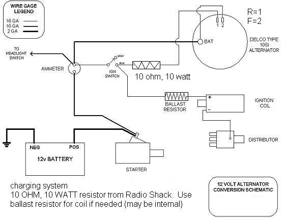

your green signal wire on #1 terminal has to have voltage from the dash to EXCITE the alternator... then you will get 14 v out of the BAT Terminal ... possibly that wire does not have a signal.. i think it goes thru a dash light..... you might try touching the #1 terminal to  #2 terminal to get 12v and see if it KICKS IN and starts charging ... The #1 terminal is suppose to be turned on and off with the key switch, and normally has just under 12 v signal.. thats why it goes thru the light bulb... you can also use a resistor to drop the voltage if your dash wire / bulb is bad....
You could check the power on #1 terminal with the key ON --- should be just under 12v... and #2 should be over 12 v with the BAT terminal.... your dash light is suppose to take the place of the resistor ....
generic wire looks like this..... look at #1 terminal - to resistor - to ignition switch.
