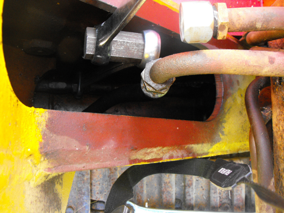

here is how I changed a hose in the loader frame of my HD6G
I used (2) combination wrenches connecting the box ends with a piece of hex stock. I used the open end on the fitting
