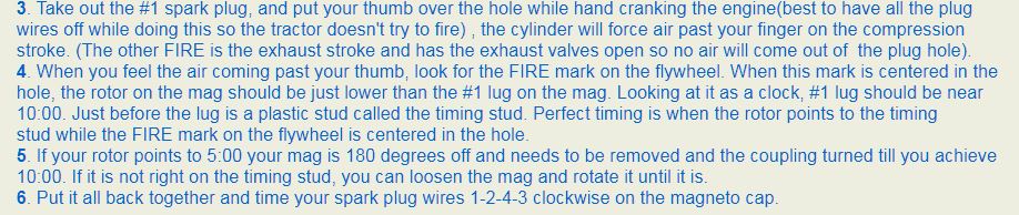

the fiber gear is INTERNAL TIMING of the MAG itself... Hopefully that was not taken apart, but you can go thru the steps to time the gears INTERNAL...
Now your ready to install on the tractor... Crank by hand to get #1 coming up on compression.. stop about 30 degrees from the TOP TDC  ( the FIRE mark)....follow the steps on Deweys post  ( below)...
Note that this is how you INSTALL the mag....( near the fire mark)... snug the bolts on the mag and continue to rotate to the TDC mark.. The impulse will WIND UP and you will hear the SNAP and the plug will FIRE , when you get to the TDC on the crank.
Edited by steve(ill) - 15 Dec 2022 at 5:58pm

ok  I am looking at the pictures [not matching up]
is this for the Farbank Moris
the mag I have is a wico is the set up info the same
right now the #1 is at the 2:00 position and timing is 1243
Mike
Points: 87040
Post Options Post Options   Thanks (0) Thanks(0)   Quote steve(ill) Quote  Post ReplyReply Direct Link To This Post Posted: 15 Dec 2022 at 8:34pm
the WICO may not have the lug like the FM does...... Another way to do it is to clamp the mag in a vise and install a spark plug wire and plug into the #1 hole and ground the plug... using your pliers, turn the impulse tangs and wind up the spring and then it will SNAP and SPARK... Turn until it sparks on #1... then turn 3 more SNAPS for 2 - 4 -3 .. now its ready to fire on #1 ....... go install it with the crank set at  the FIRE mark or before .... snug up the bolts.. ... rotate to TDC and the #1 plug should FIRE ... if its off a little, loosen the bolts and roll the mag inward or outward a few degrees and retest.

Post Options Post Options   Thanks (0) Thanks(0)   Quote WF owner Quote  Post ReplyReply Direct Link To This Post Posted: 16 Dec 2022 at 6:11am
He's right that the WICO mag's #1 plug wire port is in the 2 o'clock position. WICO has a "pointer" that comes up in a window for #1.
It's been years since I worked on a WICO mag, so I don't remember how to time it internally, but it must be timed so the points are opening at the right time.
