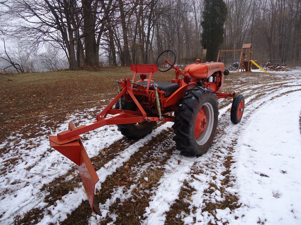

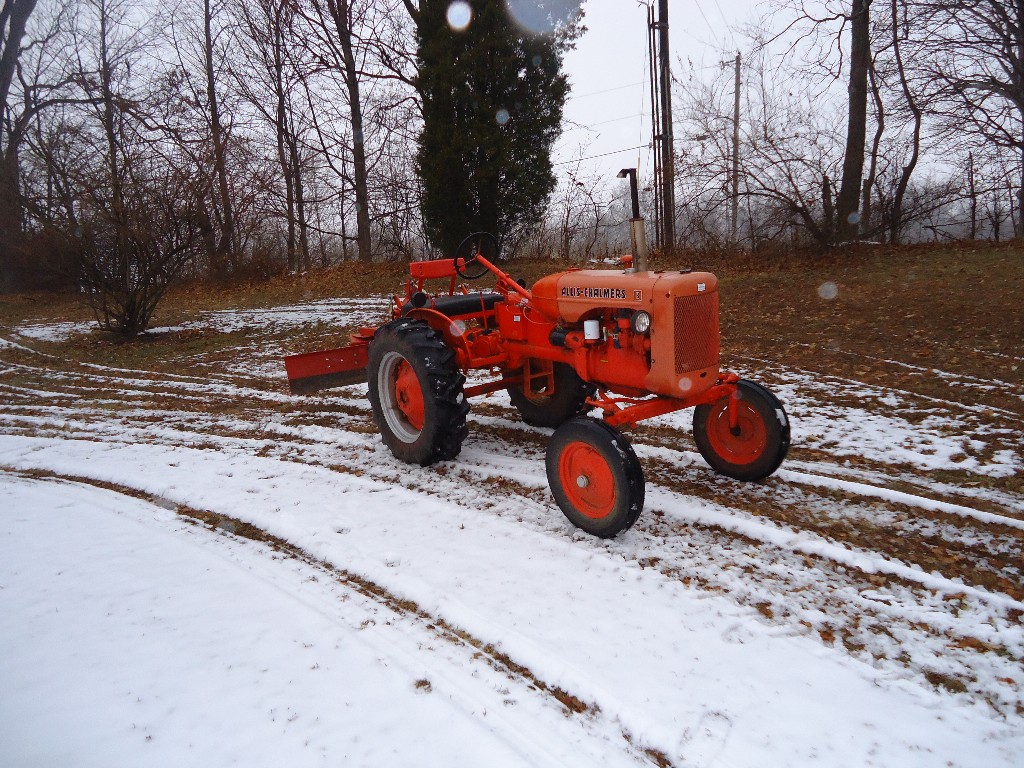

Good news, I hooked up the blade today and held my breath but the single b cylinder raised it with no problem.  I came up pretty quickly and didn't seem to struggle at all.  I also raised it all the way and killed the tractor and left it there for a while and it still didn't seem to bleed down any noticeable amount so I'm super happy and operational finally!  I tried to take a movie with my camera of it raising up and down but it was 18 megs so pictures will have to do for now but as soon as I can figure out how to take a smaller movie, I will try to upload it.  Thanks again for everyone that took the time to help me out.

Hello:   I didn't read all the replies, but I have been on www.oktractor.com  & www.tonystractors.com  and they have all kinds of part for the Allis Chalmers B.  I just bought a 1948 Allis Chalmers B two weeks ago and I really like it, it is in show room condition, and runs like new.  It cam with a blade on the front and works well for plowing my 375 yard long driveway.  This  is an awesome little tractor!   I think my wife is jellous of it already!
Scoottmiester View Drop Down
Joined: 07 Jan 2011
Location: Egg Harbor WI
Points: 5
Post Options Post Options   Thanks (0) Thanks(0)   Quote Scoottmiester Quote  Post ReplyReply Direct Link To This Post Posted: 07 Jan 2011 at 10:50pm
Bob D. (La) View Drop Down
Location: Louisiana
Points: 25529
Post Options Post Options   Thanks (0) Thanks(0)   Quote Bob D. (La) Quote  Post ReplyReply Direct Link To This Post Posted: 08 Jan 2011 at 4:55am
Ya dun good Scottmeister. That is a sweet looking B. Glad it works out so well for you. I know a B is a lot of little tractor.God Bless
PS: Wife must be jealous as she makes you park it outside instead of in garage. LOL

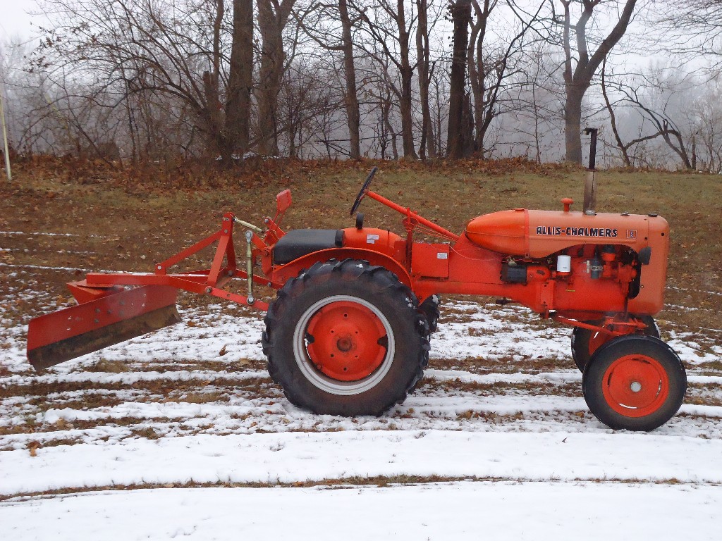

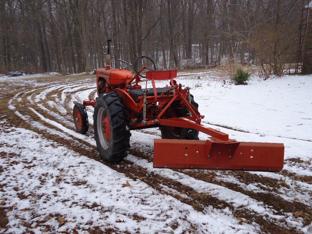

Well, I thought it was only appropriate that I share this will you all first after all the help.  I was able to use the B today to clear my driveway and it worked great!  We only had about 3 inches so far but everything seemed to be in working order.  I did notice that it takes a little extra effort without brakes (hopefully get those fixed once it warms up) but overall, I can't complain.  I also noticed a couple of other things that I need to figure out.
1. Weight on the front with definitely help the handling.  It's not too much of a problem with the blade raised surprisingly, but when you get a load behind you, it does get a little light.
2. The steering seems pretty loose and it dances a little so I would like to tighten that up a bit.
3. I was running in 2nd gear and for some reason, when I throttle up to get going pretty good it would do great for a few seconds and then the rpms seem to drop back down.  Not sure if it's anything big or just a loose linkage that's slipping.
4. Lastly, I went to fire it up and the starter didn't want to engage for the first couple times.  Not sure what the problem is but hopefully it will hang in there for the rest of the cold season.
Charlie175 View Drop Down
Location: Shenandoah, VA
Points: 6369
Post Options Post Options   Thanks (0) Thanks(0)   Quote Charlie175 Quote  Post ReplyReply Direct Link To This Post Posted: 11 Jan 2011 at 3:04pm
Your long lift arms are what helps you. Most of the kits are designed with short arms which require a bigger Ram to work. Congratulations on the B and the blade. Should work great for the intended purpose.
Charlie
