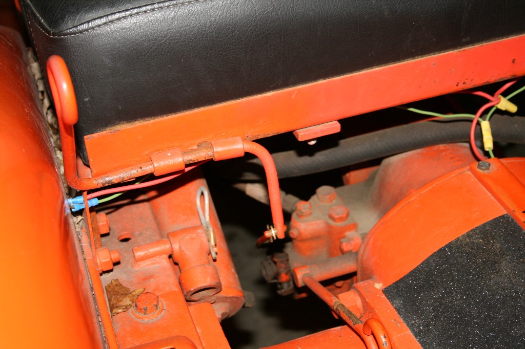

Here's a picture (hopefully, if I get it to work.)  The lever attached to the seat will not move.  It's like the small rotating part that it attaches to is frozen.  If it just needs cleaned, hopefully it's not a huge deal.  If it's something expensive, I've got a problem.
Post Options Post Options   Thanks (0) Thanks(0)   Quote CTuckerNWIL Quote  Post ReplyReply Direct Link To This Post Posted: 03 Dec 2010 at 7:49pm
Disconnect the rod coming up from the hydraulic unit to make sure the handle isn't froze to the seat bracket.

Post Options Post Options   Thanks (0) Thanks(0)   Quote yochujr Quote  Post ReplyReply Direct Link To This Post Posted: 03 Dec 2010 at 7:57pm
No, the handle wiggles around and I can move it from side to side.

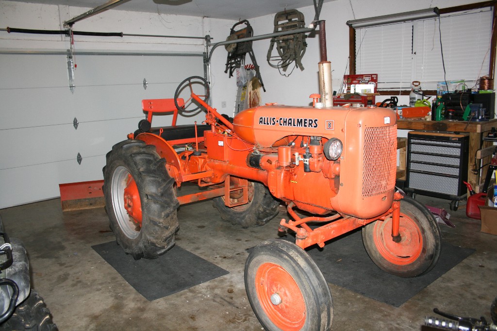

Here are some pics of the new purchase.  I got it delivered and with the blade for 1500 so I don't think it was too bad.
Points: 24876
Post Options Post Options   Thanks (0) Thanks(0)   Quote jaybmiller Quote  Post ReplyReply Direct Link To This Post Posted: 04 Dec 2010 at 6:41am
That's a nice clean,well cared for B ! You 'dun good'.Just keep her full of gas, check the oil and have FUN !!

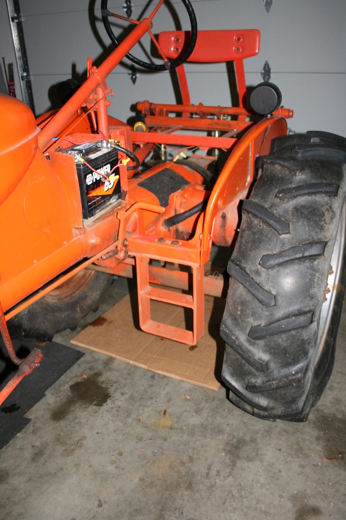

Her's a picture of the step that you requested.

You said that you got the discs to rotate. They should be seperated to rotate individually, with the springs creating friction and still allowing them to slip. Bob
yochujr View Drop Down
Joined: 03 Dec 2010
Location: So. Indiana
Points: 122
Post Options Post Options   Thanks (0) Thanks(0)   Quote yochujr Quote  Post ReplyReply Direct Link To This Post Posted: 04 Dec 2010 at 10:27pm
Yes, they do move separately now.
