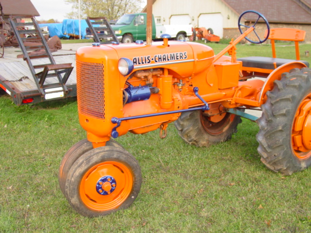

Hi
I found this pics on the web, Do you think it is a good idea to replace the steering of a C by the one of a B?
Is it working well ?

Originally posted by John426 John426 wrote:
Hi
Hey, that is my narrow front B! I bought that from Roger VanCamp years ago as a factory narrow front B. He thought is was a rare tractor and had it for years. His son broke something on it and it set to the North of his barn for years and had set up. I tried for years to buy it and one day he said he would sell it to me if I would restore it and switch it over for starter. He loaded all the necessary parts along with the tractor.
I stripped it down and Roger was disappointed when I showed him the torque tube where the wide wishbone had wore into it before it had been changed to a narrow front. It had the C steering box on it and I used the B steering box and constructed a B steering arm to fit the C steering link.
The picture with the blue was the second paint job after I put a 4 inch stroke crankshaft in it and Chevy valves in the head.
AaronSEIA View Drop Down
Location: Mt Pleasant, IA
Points: 2581
Post Options Post Options   Thanks (0) Thanks(0)   Quote AaronSEIA Quote  Post ReplyReply Direct Link To This Post Posted: 26 Apr 2019 at 6:15am
Doesn't it steer backwards?

Post Options Post Options   Thanks (0) Thanks(0)   Quote Dick L Quote  Post ReplyReply Direct Link To This Post Posted: 26 Apr 2019 at 6:21am
AaronSEIA
No it does not steer backwards.

Post Options Post Options   Thanks (0) Thanks(0)   Quote Dick L Quote  Post ReplyReply Direct Link To This Post Posted: 26 Apr 2019 at 6:32am
AaronSEIA
simple test to show why it would or wouldn't! Hold a pencil in the center and when you rotate it like the steering arm would move you will find one end will push forward as the bottom will pull backward.
In the picture on the trailer with the C the arm is up and the picture with the B steering box the arm is down. All that needs to be done is to have the steering arm on the box to push to make the wheels to go the correct way. If it steers backward just change the arm the opposite way on the shaft you have it and walla you solved the problem. If the sun is shinning bright and you can't see it look up instead of down.
It is called thinking about how things work when your making non factory changes. It makes things more fun with less road blocks.
