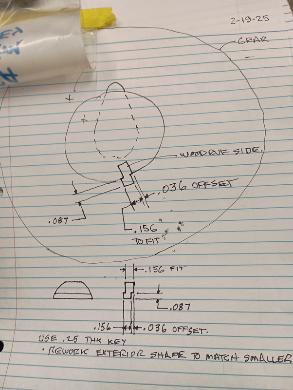

First the 105.4 degree spec minus 111 degree current lobe center line. = 5.6 degrees
divide that in half (2.8 degrees) as the cam gear is twice as big so the 5.6 degrees as the point it comes to the cam gear is 2.8 deg of the circumference of the cam gear.
Taking that 2.8 degrees back down to the size of the cam which is 1.5 inches. 2.8 degrees on the 1.5 inch dia =
I did some thinking and came up with a dimension of .036 actual movement in the cam inside the gear. That was based on the delta 5.6 angle divided by 2 = 2.8 deg on the cam gear at 1.50 dia so 1 degree on 1.5 = .013 inch. so .013 x 2.8 =.036 inches of cam movement. Fingers crossed!:)
Now we want the crank gear to come up to the 105 degree number sooner as it turns clockwise, the cam lobe needs to move to a position sooner as it turns counterclockwise. The lobe should move counter clockwise by the .036 inches.
I think I can get this movement  with a custom built offset key.

 I am going to get the offset key made in the next day or two. Decide to use a .25 wide key and trim it down to fit the keyways. That should be about .036 inch offset in the key moving the cam CCW from the cam gear.

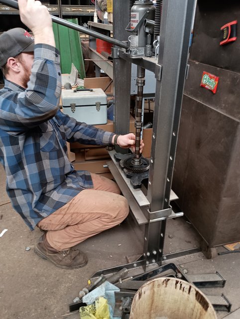

Friend Matt whittled out the offset key to my specs tonight. Assembly fit back together nicely.

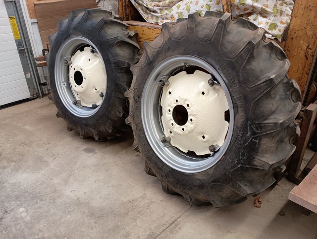

John came over today and helped put the centers in the CA wheels:
Small moves at snail pace. Weather has been cold. May get a slight break to start preparing to make maple syrup next week.
We get some results on the cam movement results soon.

Back to the real world and the old Allis cam:
Matt using his skills to mill a new key:
Cam gear and shaft re assembled:

 I installed the cam in the CA engine. Set it up for inspection of the lobe center-line again.
Checked it several times and found the numbers to be consistent at 106 degrees. The spec was 105.4 IIRC. So this is very close to the cam card and it will be close enough to allow me to carry on with the rest of the build.
I will try to check the rest of the cam lobes if I get a chance.
