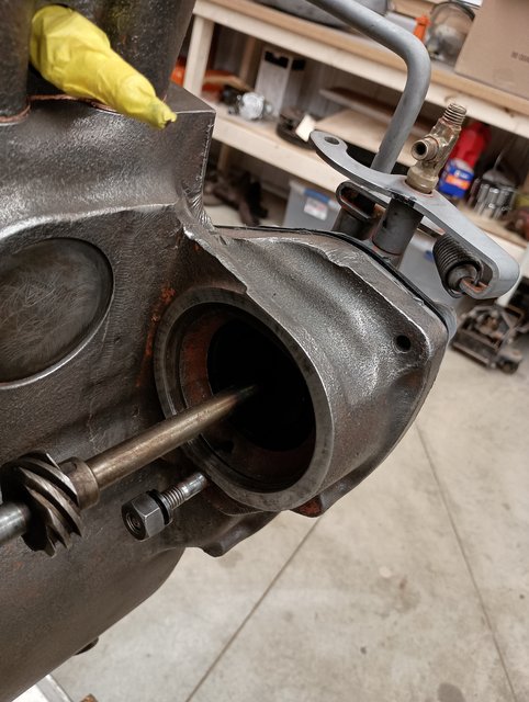

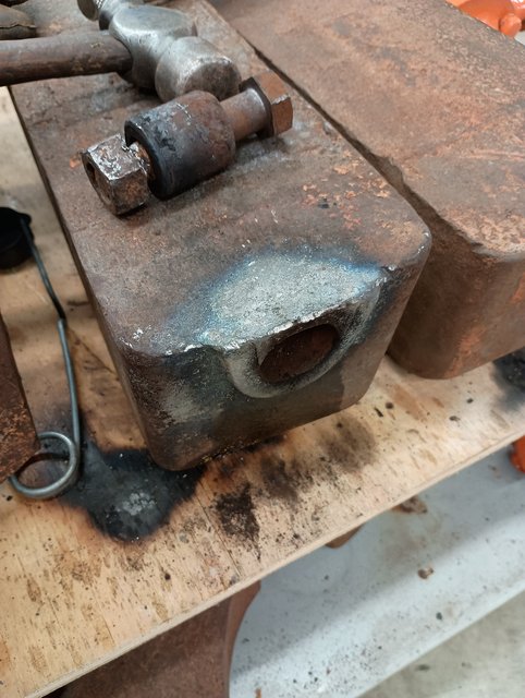

Your engine side weights aren’t actually for a CA. You have B and C weights but I think they will work.
Points: 8448
Post Options Post Options   Thanks (0) Thanks(0)   Quote Sugarmaker Quote  Post ReplyReply Direct Link To This Post Posted: 21 Nov 2024 at 8:55pm
Sparky,
Thanks! Why does that not surprise me? Everything else on the CA has been miss matched and thrown together. I did search for some CA weights and see that they are a different shape too. Am I right about the knob needing to come out and I need to find another knob for the other side. Another small project!

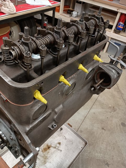

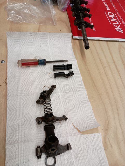

So the continuing saga of the crusty old CA:

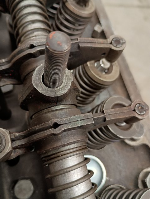

I set the rocker arm assembly on the head tonight.
As I was seating it I found that the # 2 riser/support was cracked on the top through the stud hole.
Going to see If I can find a good used one. I have to relearn about the initial valve setting again. I think I am losing it, or maybe it was already gone!:)

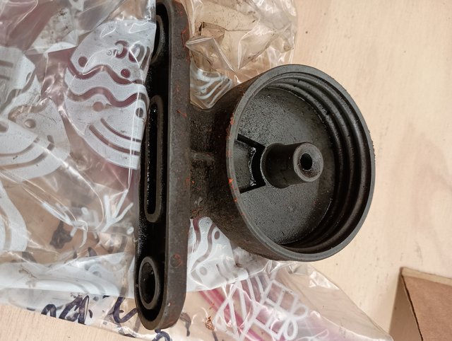

As I reviewed the oil filter base, I found a crack in that too.
 I think this old girl is playing all her cards and really is one of those tractors that needs a lot of attention! Maybe just Ms Needy?
Just small moves like cleaning nuts and bolts, Buying several hundred dollars worth of parts every few days to satisfy my orange habit! And hoping a lot!
 Looking forward to painting some parts if the weather warms to 60F again soon. Lots of prep to do! Nice that this is the only project in the shop right now too.

Chris, our CA weights has a bushing and bolt that holds it in place. I will take a picture of our weights if you  would like?

Allis folks,

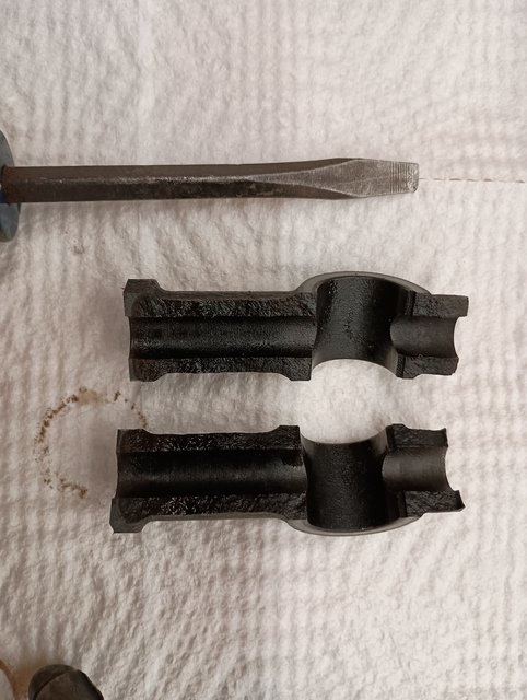

The saga of the CA continues. I took the support out of the rocker arm assembly and barely tweeked the part.
A good used one is one its way from Brenda at Sandy Lake.
She is looking for a better oil filter base too.
We worked on the B/C weights and some heat and air hammer work removed the support plug and bolt.
Most of the hardware is cleaned and ready for paint. We continue to move forward. Next big items may be the rims.

I run into those broken supports in about every other AC engine I work on, it seems. I'm sure someone overtorqued the nuts in the past and it splits them right down the middle like that.

I had to Google the one horse shay concept. I see its when it falls apart all at once. Yes about like this old CA!

Allis folks,

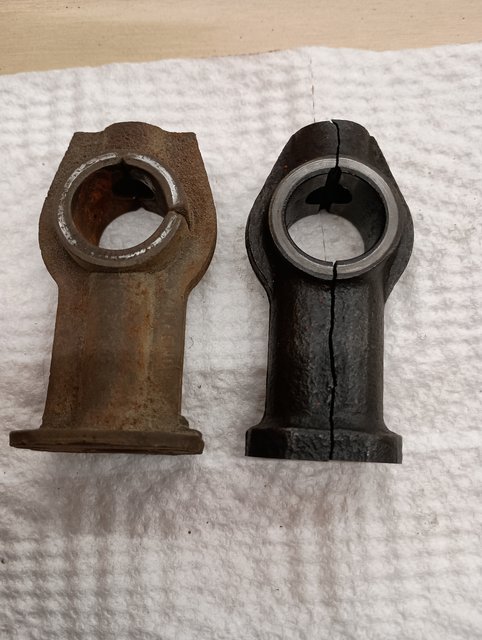

I did get the support for the rocker arm shaft. I thing this is a perfect fit for this little Frankenstein puller!
Way better than the split "high performance" version that we will set aside as another learning experience on the CA project.
Hope things are good and safe travels to those on the road for Thanksgiving!

Chris, I've seen Allis rocker-stands like that brazed back together. Must have been somewhat common.
Points: 8448
Post Options Post Options   Thanks (0) Thanks(0)   Quote Sugarmaker Quote  Post ReplyReply Direct Link To This Post Posted: 26 Nov 2024 at 6:54pm
Mike, Folks,
I don't think I would trust a brazed version. But I understand the concept! If these are the same as WD and 45's then I probably threw some away during clean out a couple months ago. I know! I should not throw anything orange away!

I too have seen them brazed and I have done i to some of them myself.  I think they are better than new, they have held together for a long time now.

That type of break is common on cast iron rocker stands and not just on Allis equipment.  Many engines used those and overtightening the hold down nuts is what breaks them.  I've brazed many in the past and if done correctly it will be stronger than the original casting.

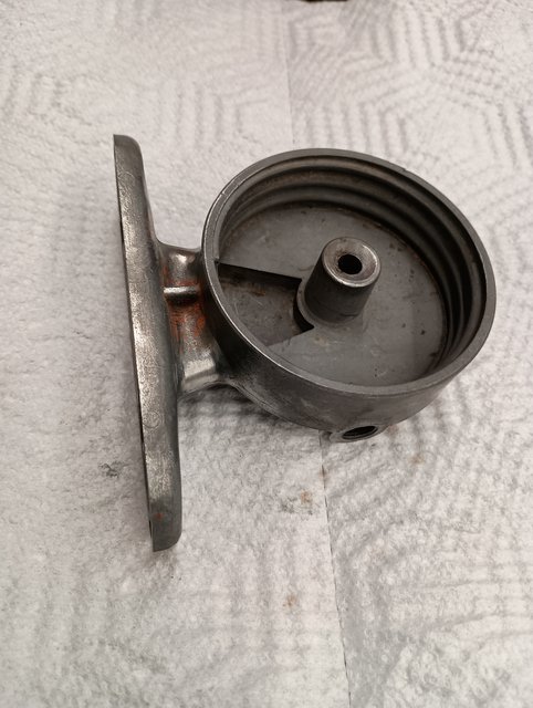

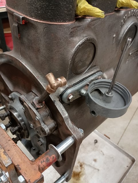

Guys,
 I got an nice used oil filter base from Sandy Lake Imp. We have been very busy trying to keep dug out from under the snow. About 2.5 feet in our area maybe more?? Also the F250 is in the shop with the front end torn apart. The Allis D14 wouldn't start, my fault I left the gas on. The starter just doesn't want to spin the engine over very fast. Took over night to charge the battery and still had to use a jump pack. Got dug out.  Then the water system stopped functioning. I think the submersible installed in 1997 finally quit. Opened the well to find the steel pipe in the pit less adapter had rusted off. Had to fenangle a chain under the adapter and Grandson Mike pried up and released the adapter. He went to purchase all new pump, line, wire, and items for the repair.

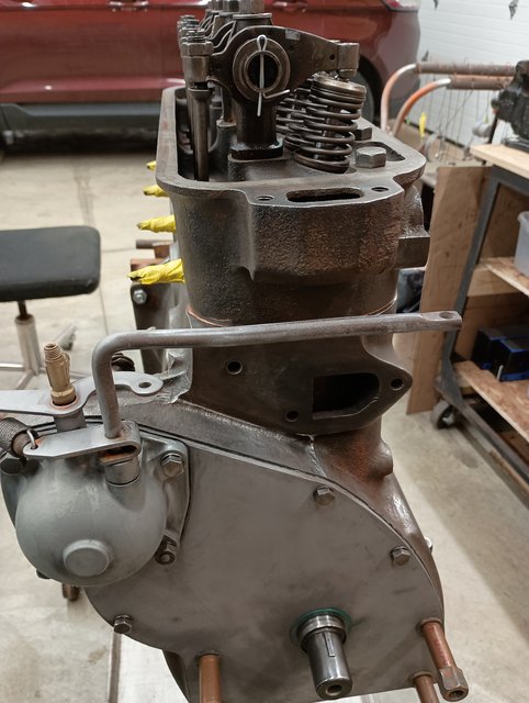

AC Folks,

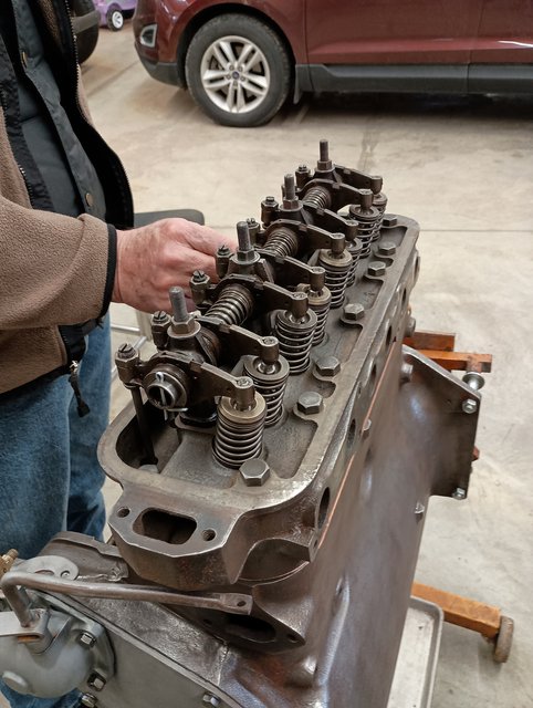

The CA project begins to move, thanks to our friend John. He helps me get things done and uses the shop for some of his projects too. I have most of the parts now it just needs to be put back together.
So we installed the rocker arm assembly. Then proceeded to relearn how to initially set the valves. Oh it took the Allis manual, a computer and two old brains! We had fun but had to make a couple runs at it.
The steel formed shaft support has to be installed with the slot in the horizontal tube installed away from the valves. I accidentally got that correct.
So we move forward slowly. We used a bar in the rear bolts of the crank shaft to gently turn over the engine. Next item may be the oil pump, to be cleaned, checked, assembled, and re-installed on the back of the block. Short term goal is to get the engine assembled. Then painted and attached to the torque tube. Man I hope I can remember how these parts go together?
 Chris and Cheryl

the gasket for the oil pump did not fit well. An Agco made in USA item but its not really close. Had to open two of the small holes in the gasket to allow screws to enter.
John cleaned up the oil filter die casting. i sanded the base flat. and we mounted it and the gasket to the block.
Trying to decide how much to put together prior to prime and paint?

After thinking on the oil pump. I need some feedback.
- So the gasket is paper thin. I could try to carve out a new gasket?
- I added a thin coating of sealer on the top and bottom of the gasket. After thinking ..... maybe not the correct thing to do? Would the sealer increase the gap between the end plate and the rotating vanes and decrease the oil pressure?
Open to ideas. Just second guessing myself. And don't really want to take this apart after the tractor is together.
