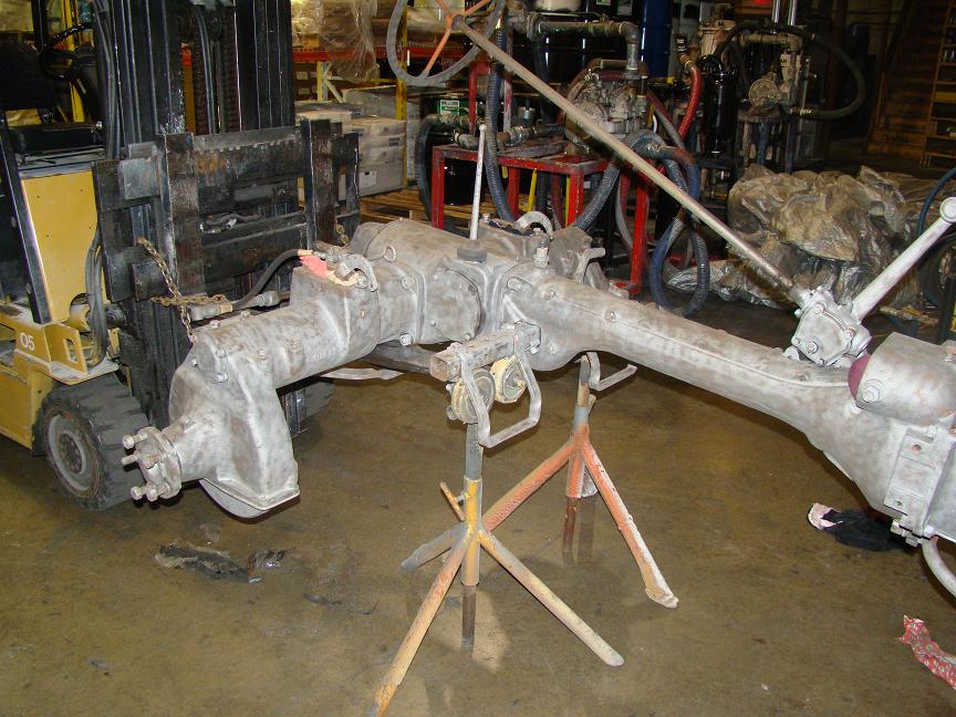

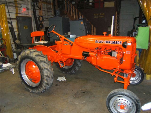

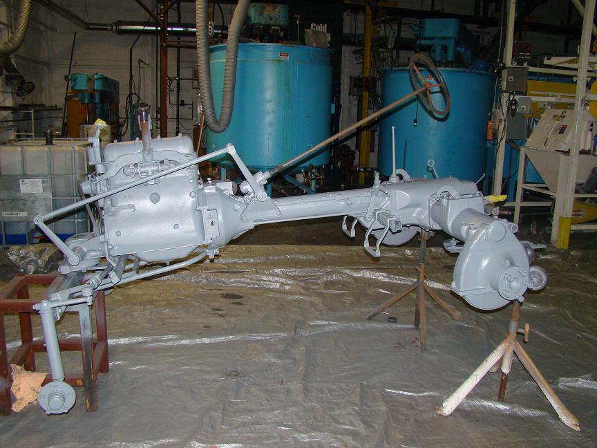

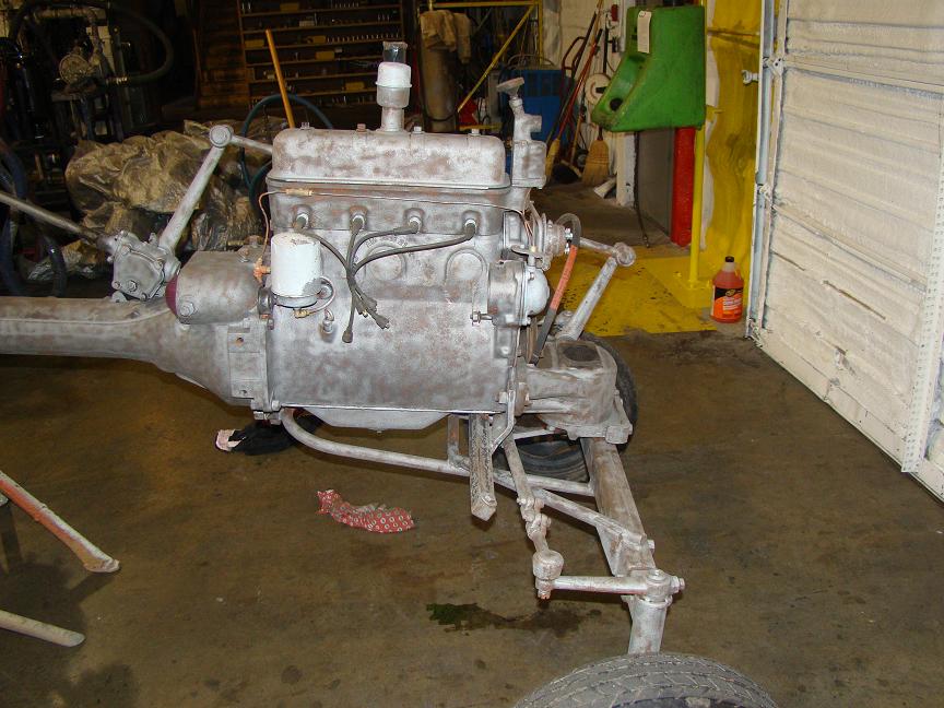

I posted 12-8-09 about my "C" that would not go into gear.(see 12-8-09 post)I would like to thank those of you that posted with a response to my problem.I locked the clutch down ( 1 hour)and then put tractor in reverse and rolled forward and clutch broke free. I have enclosed a couple of photo's of tractor. Tho not perfect it looks pretty good for my first resoration project. Thanks Vance

very good looking C, you done good!!! Thanks for posting photos.

Orange Man,  Great job on the C.  You all never cease to amaze me the lengths you will go to to restore these units.  I know it did not look that good new.  Great to hear you freed the clutch.

Looks good, what are you using for front tires and rims?

Nice looking C! I like the steps for climbing on board - my C has an implement bar that serves the same purpose for me.

Looks like you got quite the place to work on em too!  Looks great!

Thanks guys,even my boys (20,18 years old )were impressed.Their comments made me feel good! I was told the front tires came off a chevette (doughnut) I have one original tire and rim that came with it and I am looking for the other. I am fortunate that my boss lets me work on unit at work after hours and during the weekend. This tractor took me one month to restore. Thats doing my chores well after dark. I think I will wait til warmer weather to start on my WD45. Once again thanks for the help Vance
