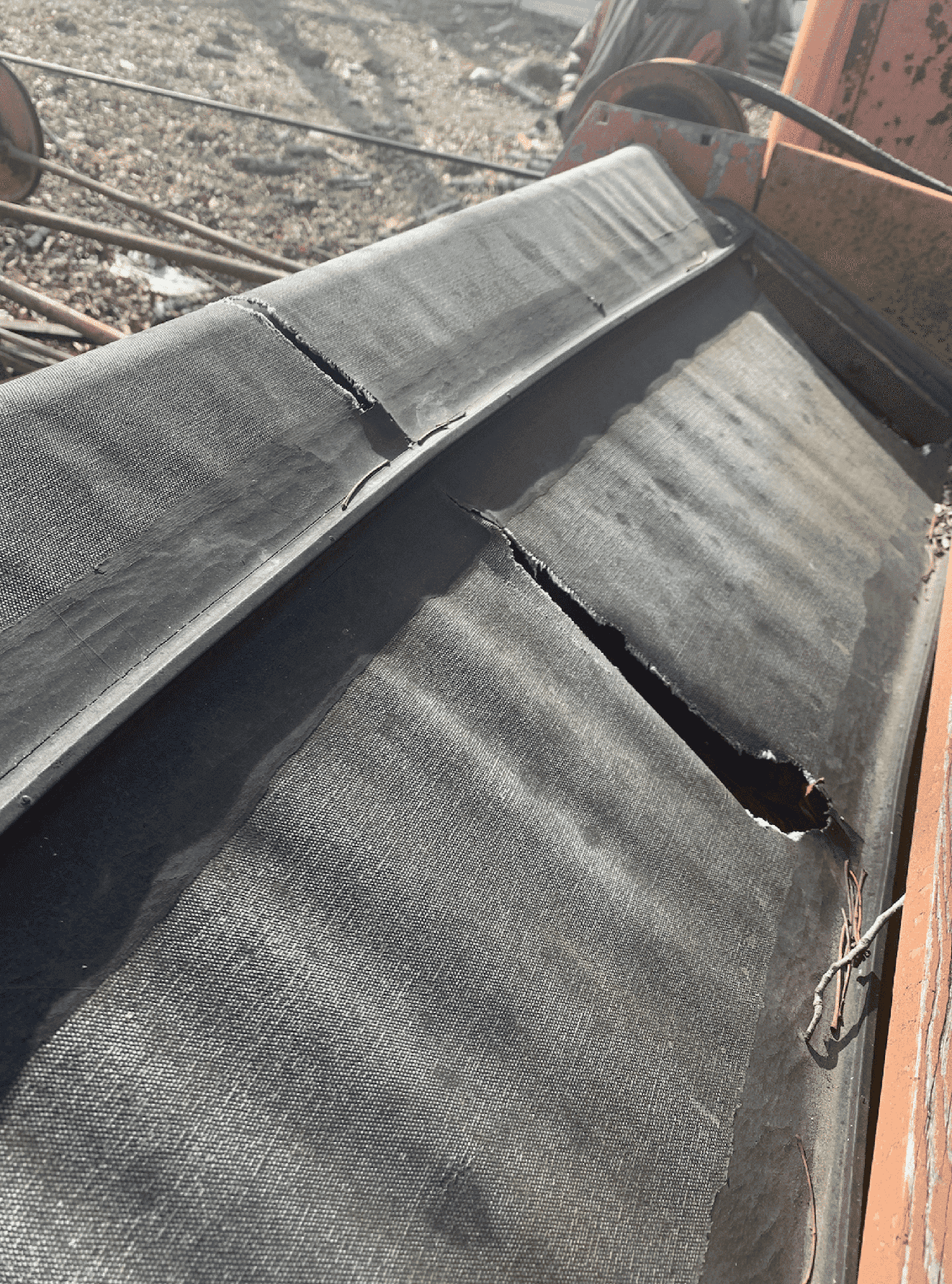

Hi all
I found an all crop on marketplace I am interested in. The upper draper seems to have a big tear in the top of it. The current owner says it could be repaired with gorilla tape. Would this be okay? If not how much is a replacement? Other than that it seems to be in okay condition.

I don't know how big this tear is and how much you plan to actually use the combine but the Gorilla tape seems kinda sketchy. Surely it can have a patch sewn on it depending on location. Ryan

Gorilla tape isn't going to work. Just get a new one. The aggravation of a ruined draper when you have a field ready to go, is not worth the savings.

Most any good upholstery shops can patch or repair them if they’re not too bad or a new one can be bought from https://www.americasbelting.com/

This is the tear in it, I see a new replacement one on Americas Seed and Belting cost nearly $300 without shipping, allcropharvester website isnt working at the moment, can this tear be repaired? Is there some sort of upholstery tape with contact cement I can put on it? Would sewing work on this big of a tear?

If you replace it, it would seam to make more sense, pardon the pun...  Looks pretty frayed and flimsy, to be repairing.  JMHOWink

The rip is in a direction the patch will have low stress. I'd try a repair first.
Loosen the tension and find painters drop cloth from the hardware store. Some are blue jeans like canvas. 9x12ft for $20ish. Or old blue jeans.
Know anyone with an industrial or furniture fabric sewing machine? Or a 1950s "black iron" domestic machine? Might find one on Craigslist or Facebook marketplace for under $50 in working condition, since they are as rugged as any industrial. Sailright sells a modern heavy duty machine for sail making/repair but they are quite expensive ($800ish?)
I'd coat the new canvas repair with oil based paint. Converting the repair to "oil cloth" canvas.

So put the new material over the tear and sew it in, then paint it with oil paint?

If you could find an old canvas tarp, that material is really tough, if you are going to patch it.

In the tarp/canvas department of any farm/fleet store, there is a product called tear grease. If you pull the canvas out, and do a really good job of gluing a small strip of canvas on, over the rip with this tear grease, it'll last for a long time.

I have used pieces from another old canvas and glue them with rubber cement both on my 66 and 12A. So far so good.

I've used this product called Tear Mender to repair low stress tears with excellent results. I have some old canvas I cut up for patches, and use this glue. Stays flexible and soaks into the material. I have some repairs that are 10 years old and the machine's cut about 60 acres since then, and it's still holding very well.
But with all this said, yours is a very significant tear, and I personally would replace it. Working with malfunctioning canvases in the dust and straw and heat when you should be harvesting is not a good time. Check out Colby Canvas Company in Colby, KS. They make and sell rubberized canvases and they are top quality!
