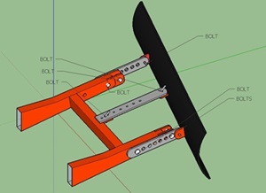

yes, the load needs to be transferred to the rear axle area by means of a loader frame, or c-channels run under the tractor to the rear end.

Good point.  I had not thought about all of the force on that one bolt up front.

Here a possibility. Mabey too weak?
'40 AC B - My Pappy always told me "Use your head for something other than a tack hammer!" I did. It makes a great 16 pound sledge hammer.

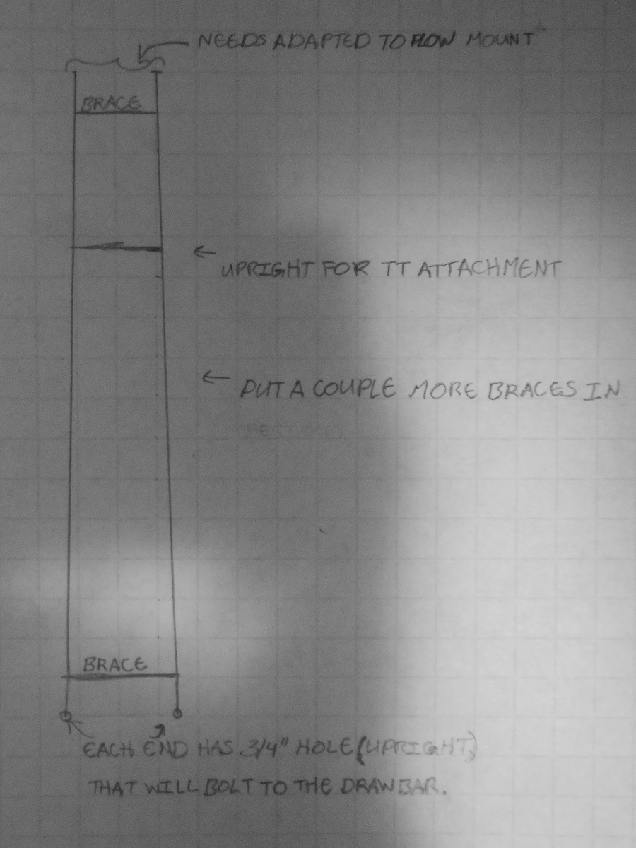

I have been tossing the idea around for a while of buying a plow for a truck, but without the full mount (sorta like this) and making a mount for it like this
and the side-view
The back of the frame (the end w/o the plow on it) would bolt to the drawbar, and it would be attached to the TT by an upright bar.
(Scale: 1/4in. = 6in, one small square =1/4in)
I was going to get a pump of some sort, and attach it to the main belt on the front of the engine. This guy on YouTube has a pretty cool set-up for his pump, I might do something like that.........I still have a while to think on it, though. Wink
Edited by BenGiBoy - 02 Feb 2016 at 10:01am

I put a plow on my '41 B many years ago. The plow frame was almost identical to what Ben drew in the post above. Anything has to be fastened to the rear or you might bust the torque tube. I mounted a drawbar using the front holes in the final drives so that the drawbar curved forward. A 7' plow on a B would be overkill. Something like 5 1/2 or 6 foot would be better. My plow operated with a hydraulic pump and reservoir that was mounted behind the seat and powered off the PTO shaft. There was a hydraulic valve in the reservoir that operated the pump. But a B can be a good plowing machine. Bob@allisdowneast

Allis made mounting brackets for the B, C, years ago. They consisted of the same channel as used on the WC and mounted on the front plate at the engine and on the front torque tube bolt holes. Same as a cultivator. In the C the used the cultivator square cross bar to mount the front. Then in front of the grille there was an H frame and the blade mounted at the bottom and the hydraulic cylinder mounted on the top and it was adjustable up and down and used a lift bar similar to that used on a pickup truck blade. I have one for a B and my neighbor has the channels for the C. Bob
