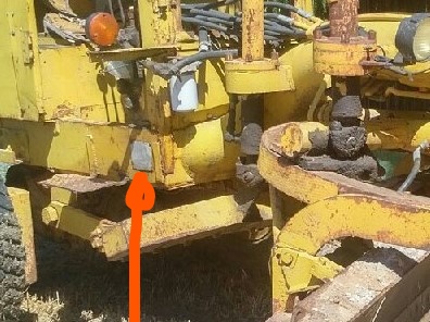

   Hi.    The serial no. will be stamped onto an aluminum plate in the location shown in this picture.
   The engine should be a D17 diesel 4.3 L, 6 cyl. (262 cu. in.).
