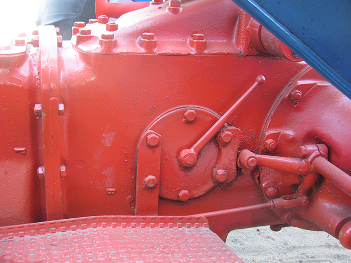

finally got the 8N resurrected and running good but now no hydraulics.
the service manual identifies this as the pro control lever... but says nothing about on/off positions.
both the PTO cover and this lever seem to be frozen solid, so I can't just move it and see what happens.
all I need right now is the hydraulics.  PTO use will come later and I'll tear into it and fix things.
so... for now... can Creston or any of you other 8n owners puhleeeez let me know if I need to move this lever to use the hydraulics.  and which direction?
then I can move on to doing the final sweetening on my beloved B.
so big thanks in advance.

drob, you gotts to have the pto engaged to run the hydraulic pump.  Creston should chime in on what position you have the pto in.  You could go (engine off of course) to the rear and twist on the pto shaft.  If it turns you got it out of gear and the hydraulics will never work.

IIRR, forward is pto and hyd, straight up is N, and where it is now is pto gear running off of rear (ground driven revolution).  X2 on pulling the bolts, and looking under, to see what's goin on...

The 8N PTO never is independent of the transmission, it is an extension of the intermediate transmission shaft, doesn't have its own gears under any situation. The hydraulic pump is driven by the PTO shaft. When engaged, its always ground drive essentially and it is important to have an overrunning clutch on the PTO driven implement or if the implement has some spinning inertia like a mower pushing in the clutch pedal won't stop the tractor's motion because the PTO shaft is always coupled to the tractor final drive unless the PTO is disengaged and disengaging while the mower is spinning will chew up the coupling.

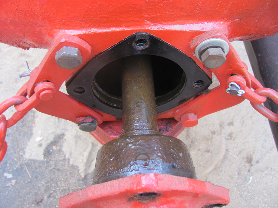

I got the screw on PTO protector cone off with semi-gentle persuasion and out came some of the ugliest fluid I've ever seen.  only a few cupfuls, but yugga - even had some small, soft black chunks in it that easily crushed between fingers.  sludge-lets.
could be seal fragments I guess.
but at least I was able to confirm that the PTO is operating currently.

He had to move the lever to turn the pto on and off.

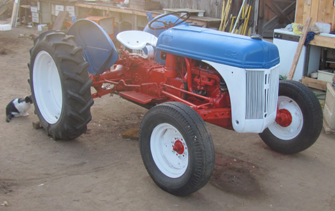

the tractor is red, white & blue and white stars will be added to the blue hood.
it will be backup for the Heritage High School Patriots occasional parades and a look-alike twin to the Ferguson TO20 we are resurrecting there.
black & white cat is considered optional equipment.  he's usually on the seat.

drob, While I was out in the barn today I checked out the pto lever on my 50 8N.  To the rear is engaged and forward is disengaged.
And it looks like John gets the prize, cus it looks like the previous owner managed with the pto engaged all the time.

looks like I have to pull the shaft and change the seal, 'cuz the screw-on protector cap is all that was keeping the fluid in.
and I will want to use the PTO, so I can't just screw the cap back on and ignore the problem.
