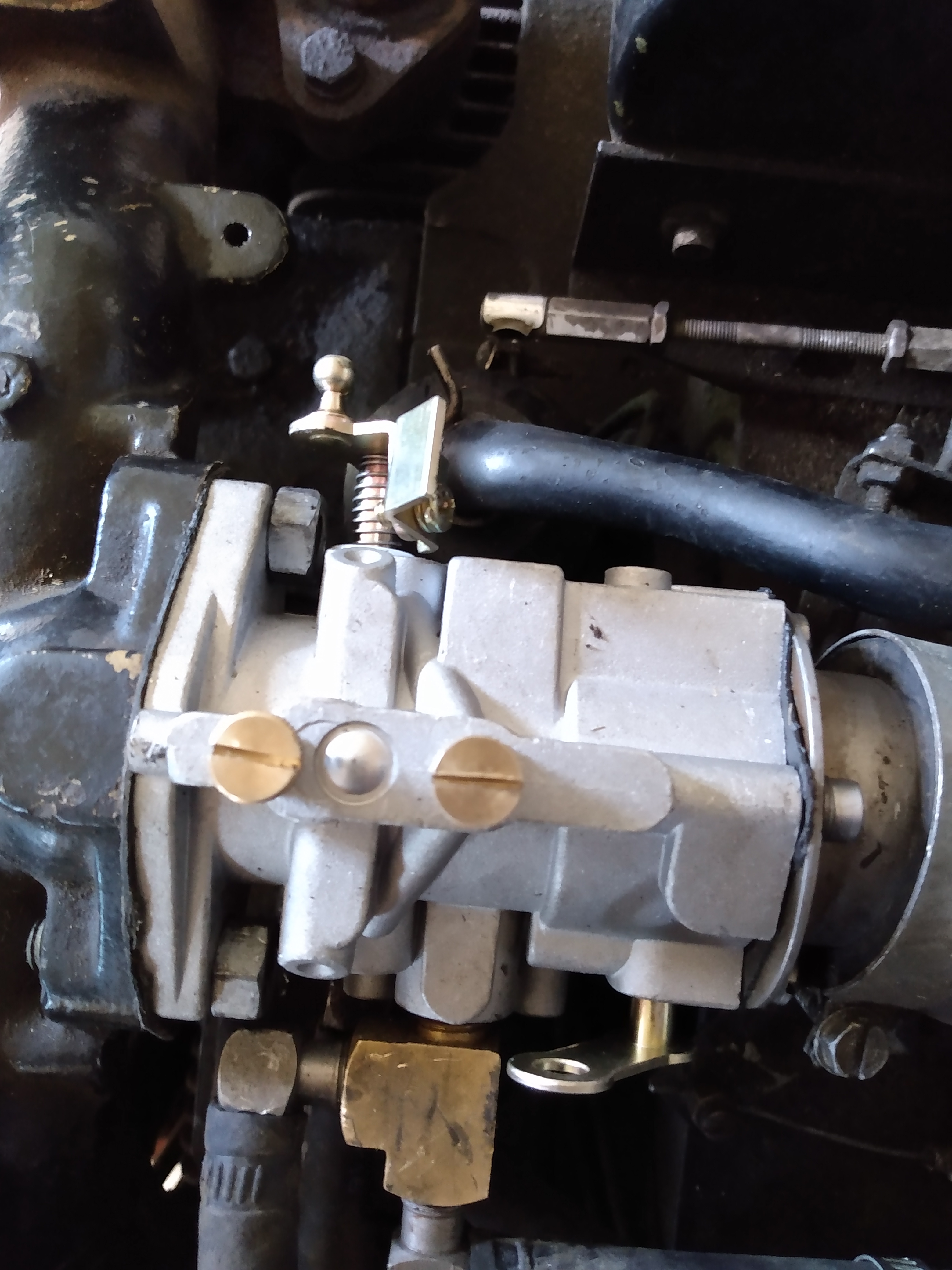

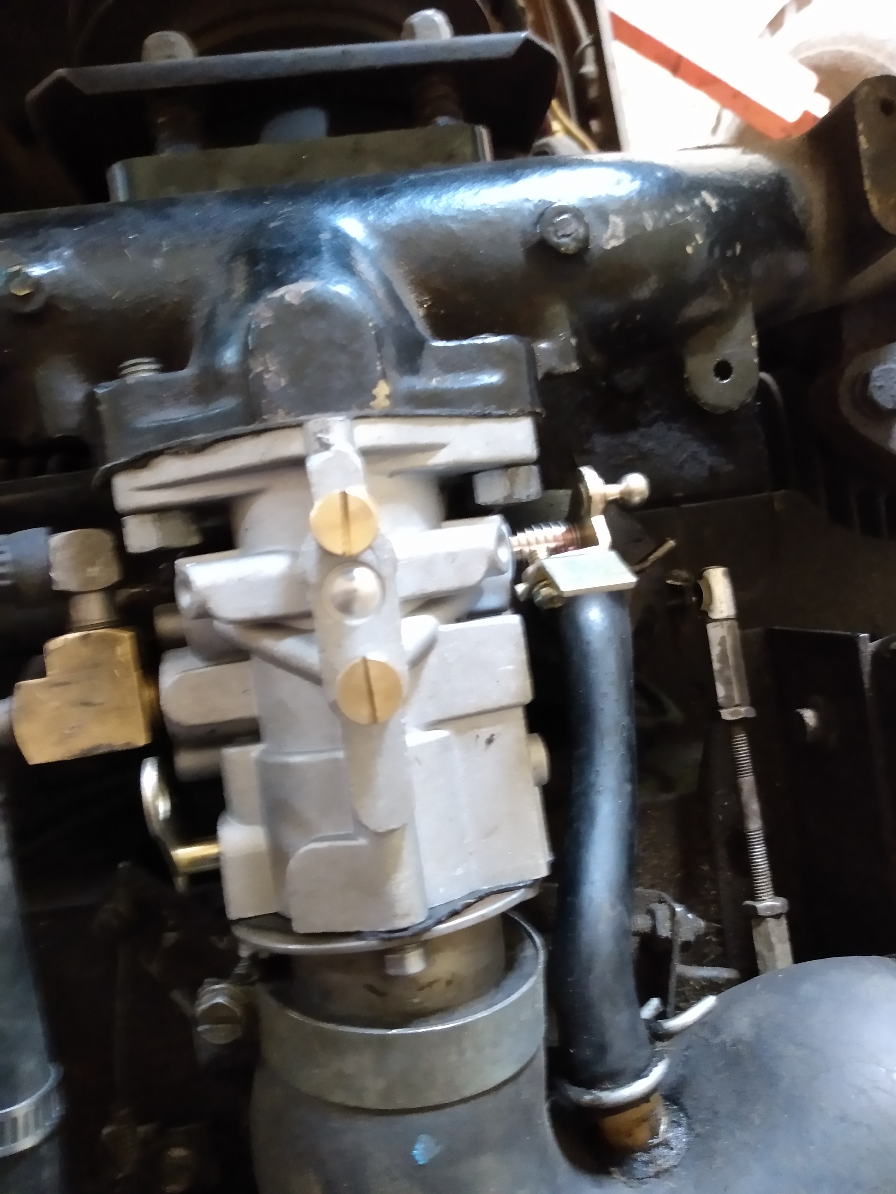

I bought this kohler carburetor last fall and just installed it today. Took awhile but got it adjusted right and ran better than ever. I do need to make some modifications. The throttle control arm is about 1 inch to the right of carb. Does not line up to work correctly. Any suggestions on solving this problem would be appreciated. Thanks. rrhead(SD)

Almost looks like it's missing a piece in between.  Perhaps rig an "L" shaped piece to bridge the gap (?)

I would say, bend a dog leg in the threaded rod, pick yourself up a coupler to screw onto the rod and add a little more threaded rod to the heim end to reach the Carb ball. Viola!

Thank you for the responses. I got it to work yesterday by taking the ball connector off the old carburetor and putting it on the new one. It was about 1/2 inch longer and the throttle rod is still at an angle but worked fine. I bought the new carburetor on E-bay and was under the name Kohler K482 K532. Here is a link to one. Don't know if this is the same seller or not. Thanks again. rrhead(SD)

I looked at my 720 and the link is at that angle.  Looks original to me!
