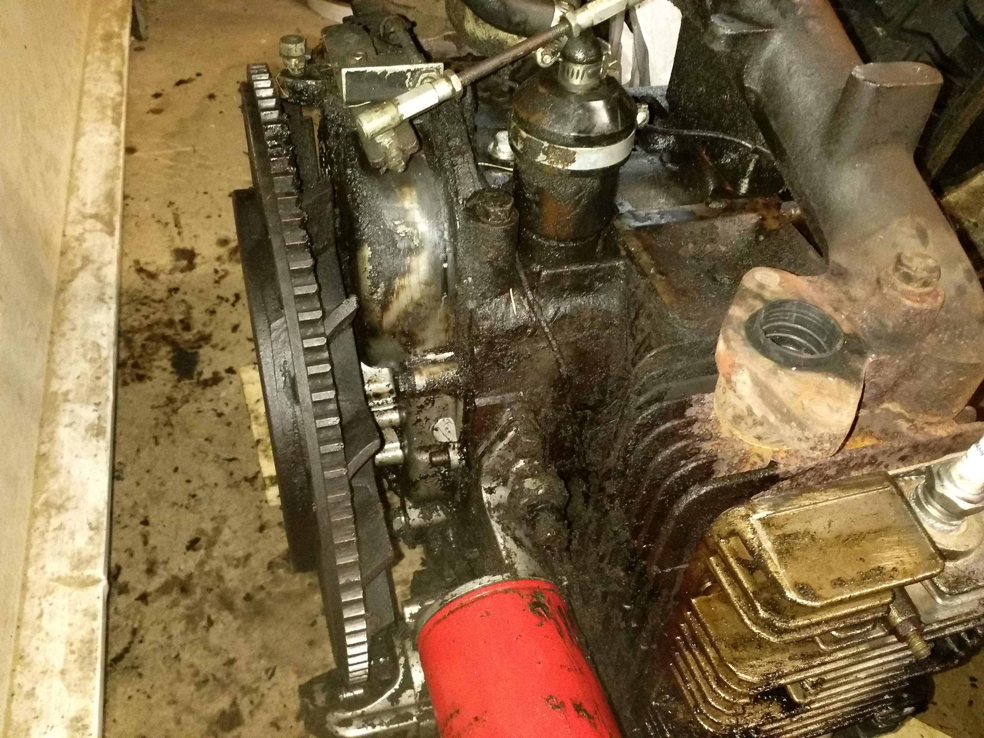

OK, so here is what I would like to know. What things should I be doing/checking while the engine is out.
Back story... I had a pretty bad oil leak that I could not trace without pulling the engine. After pulling the engine and removing the casing, I was able to find the issue. One of the bolts for the oil pan had worked itself loose (read - halfway out). I have had previous issues with one motor mount bolt coming loose, and one of the hood bolts as well.
So, I would like to know if there are any issues I should be addressing while the engine is out. Would hate to get it all back together, just to find another issue that would require me to remove it again.
Thanks
Skipp

Exactly what I ran into. The grass and such was packed in tight around the starter. With the oil leaking from the pan it was a gunky mess. It was also packed in under the casing at the back of the engine.

It definitely needed to come off though. It was not pretty in there.
