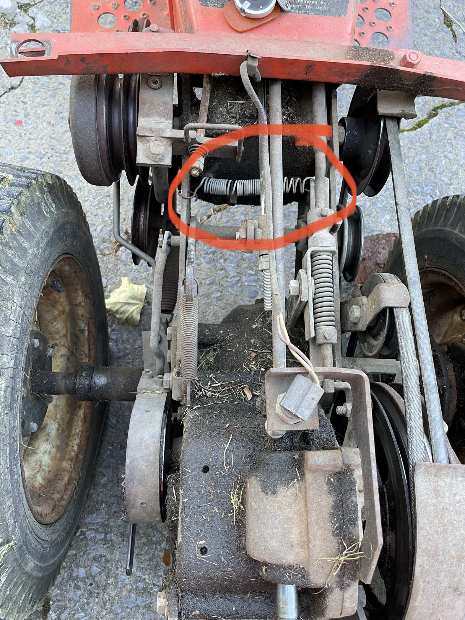

I think I need to replace a spring in my 712 Shuttle, but I cant find the information about the spring in my manual.
I could also use some tips on adjusting the clutch. 3rd and 4th gear won’t pull me up any kind of embankment at all, and now it’s losing the power in 2nd as well.
Thanks in advance!

Spring Found. It was listed as "Spring". Lol

Probably need to tighten tension on drive belt going to tranny - should stop the slippage in 2,&3. Good luck!

Thanks! I have replaced the spring, drive belts and brake pads. Seems to be running much better, I just need to make some minor shuttle adjustments.
