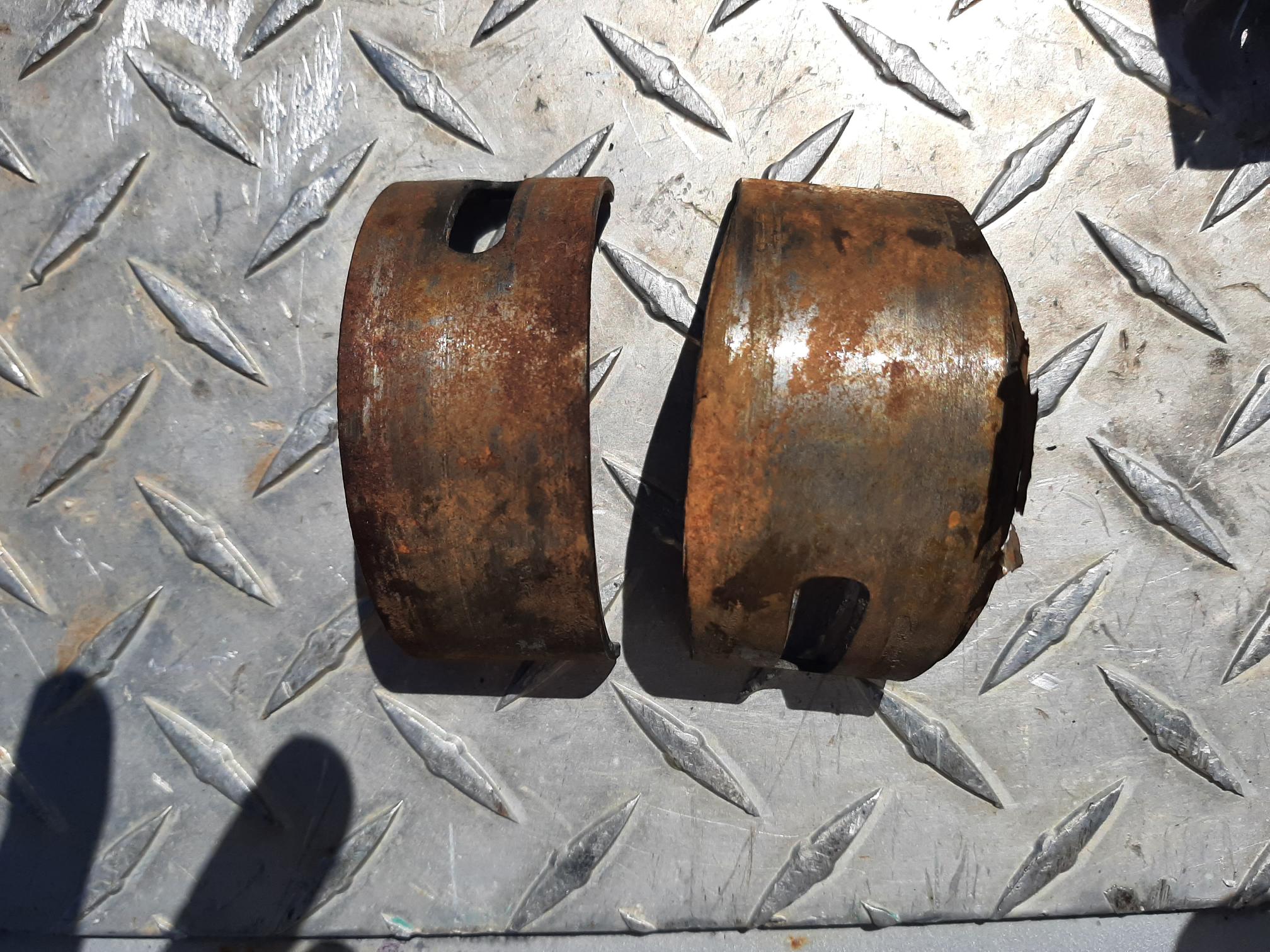

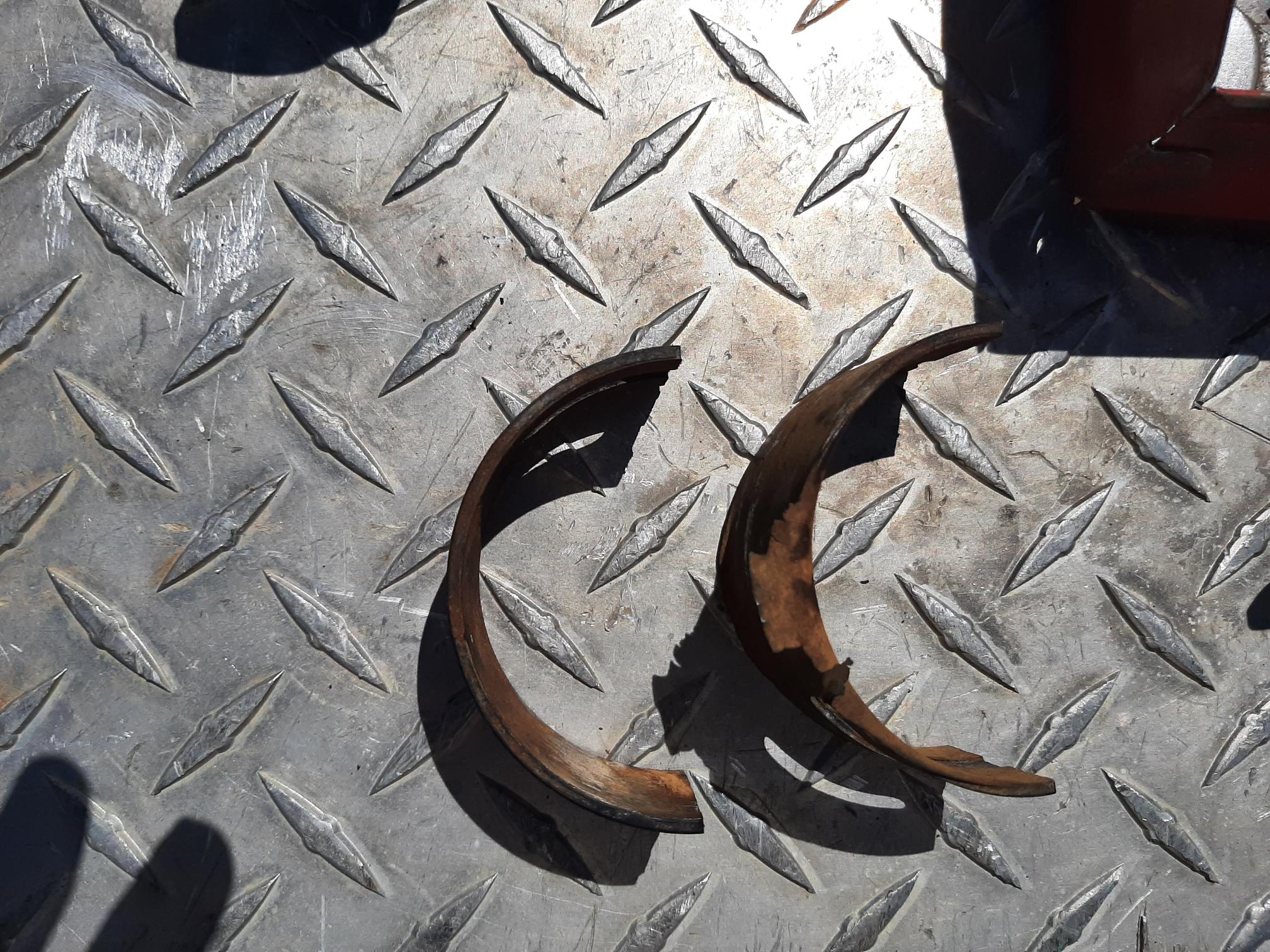

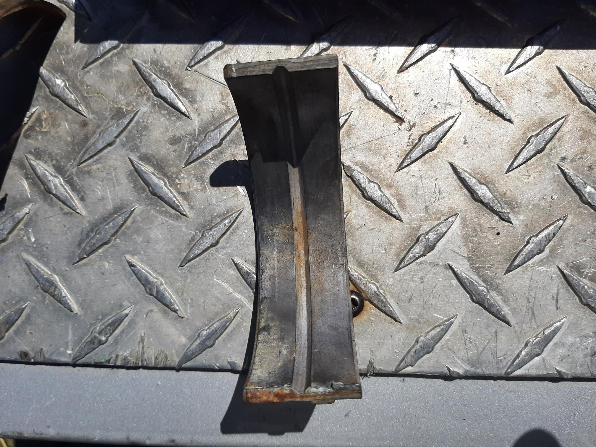

Hello, I know this topic has been discussed before but here is my particular case. I have 1975 7060 that has a spun rod bearing (see pics). I got through auction as a "parts tractor" so I don't know anything about the rest of the tractor. Is there any way to get tractor running without embarking on major overhaul first to evaluate other tractor operations/soundness?
Tractor seems intact in most other ways - roosa master IP was taken off and I don't believe tractor timing was done b4 hand, antifreeze and other fluids look ok, residual oil in pan black with metal fragments but no water/antifreeze, tranny and rear end fluids look ok, hour meter shows 1336...
If I did overhaul, it seems that past posts have indicated crank removal, magnaflux crank and other parts, maybe could turn rod journal and add undersized bearing, new rod/rod cap bolts, etc. can this be done in-frame?

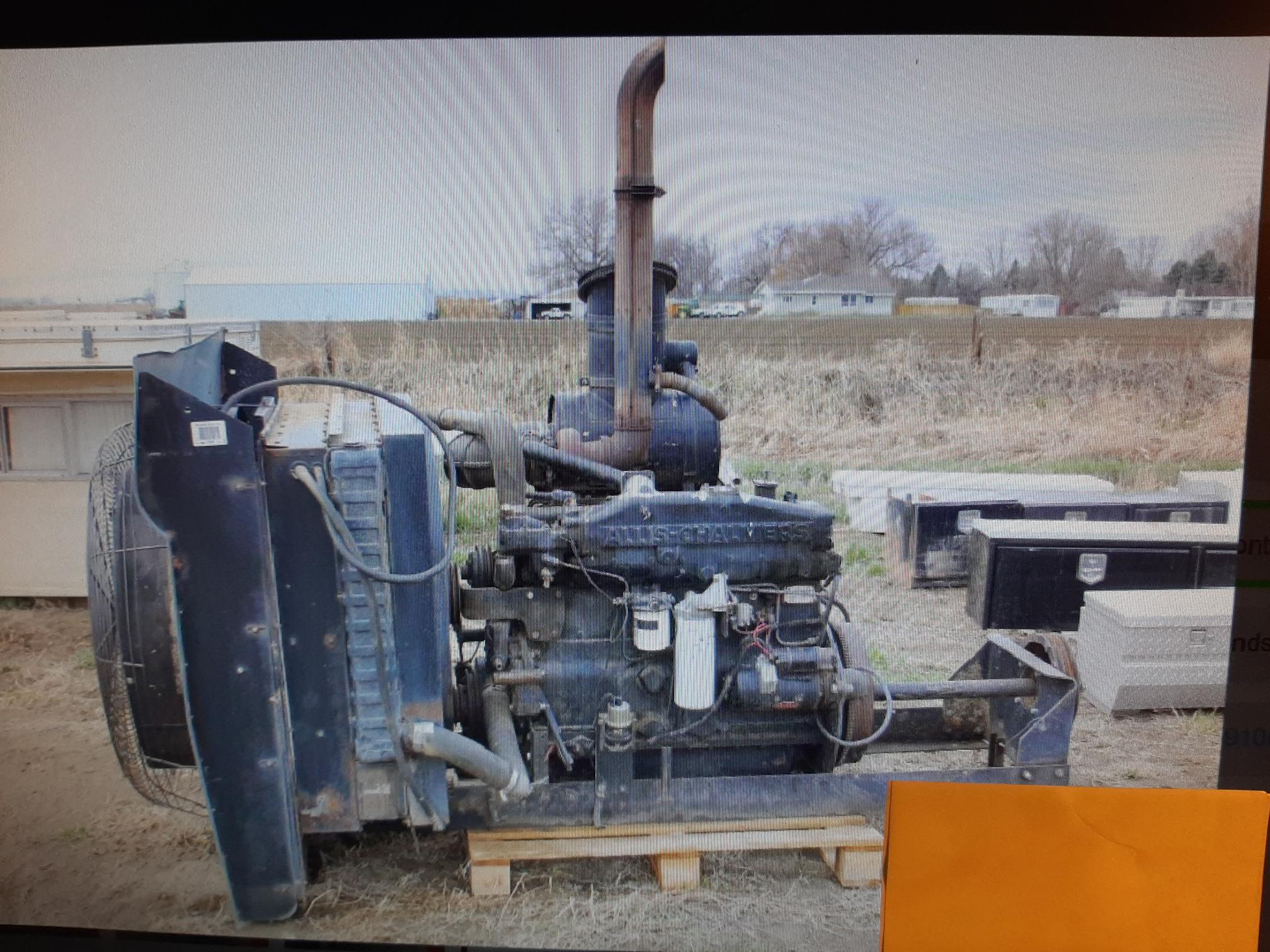

Other option is to swap a 670I combine engine into tractor. which as Dr Allis has pointed out isn't necessarily simple but others have done numerous times.
looking forward to the wealth of experience on this forum and it is greatly appreciated! hope pictures come through.
Thx
Tim

Maybe try pulling oil pan, valve cover, & oil filters. Cut open filters to unravel paper medium. Then closely inspect pan, top of head, & filter medium for amount & size of metal that was possibly circulating thru engine? That may give a better indication of severity?
While pan is off, a simple coolant pressure test may indicate any piston sleeve’s o-ring &/or sleeve cavitation/leaking of coolant?
Then go from what is realized/discovered. Good luck.
If it were mine & coolant pressure tested ok, rotating assembly rolled over, & oil filters caught much of metal fragments, I’d consider rolling in some good used bearings on both crank & rods. Or at least roll-out/clean ALL old good bearings & reinstall them only replacing poor one with good used?Smooth up any grooved crank / rod journals. Maybe an AC forum member might have a few good used bearings?? If so, then Purge oil galleries & clean/check oil pump functionality. Then time injection pump. Remove injectors & do a pressure check. Reinstall injectors, reassembly pan & fill with some good used oil & filters. Hook up 2 batteries & give it a spin? Leave valve cover off to monitor valve action, push rods, oil delivery, etc. Then if that all checks out, do a compression test. If everything check out, give it some fuel & see IF &/or how it runs??

Emery cloth the cheap out of the journal and check size. Get undersized bearing to get close. Reassemble and run at idle only. Check condition of rest of tractor. If good decide on rebuild or transplant. This isn’t a fix but a way of determining rest of tractor condition.

Thanks AC7060IL for in depth msg. the residual oil in bottom of pan had metal fragments of course. didn't have time when I took pictures to examine closely. the former owner had dropped pan an inspected and the rod bearings that were removed (i guess) were in bucket with pan bolts when I got it. rod bearings were in pretty tough shape (I will try to post additional pics) and as you can see the journal and the rod arm bearing surface bit rough but I would have thought they would look worse. I assume the bearings softer than the journals/rod surfaces? bearings looked worse for wear for sure.
I will definitely do the inspections you suggest but I am out of country until July - would like to get into it right now but will have to wait. One of the oil filters was gone when I bought tractor (don't know how long it was off) I screwed on a extra filter I had just to seal out dirt..
would I just put a little air pressure in radiator for O-ring/pitting test?
also as im4racing and you suggest will emery cloth smooth up rod journal on crank? can't really get to rod arm surface much but I guess this is just to investigate tractor ops and see where to ultimately go after that.
I am not a mechanic by any means just grew up with equipment and wrenched on it enough to be dangerous I suppose. lol
will have a lot more questions before this is done - thx for the help.

MT7050, After re-reading all of your replies, it sounds like an oil deprivation issue may have happened to engine to take out rod bearings??
Maybe investigate oil pump & it’s drive mechanism? Also cut open its remaining oil filter to inspect for possible collapsing paper medium &/or dirty pressure relief valve?? If needed, YouTube how to open-up an oil filter for inside inspection.
During coolant pressure test also inspect radiator, & water pump for defects/leaks.

hope i didn't mislead in previous post when I referred to bearings (plural). It is only the #4 cylinder that the rod bearing was spun on. or at least that is the only one the previous owner removed. I have not pulled any other rod caps but they look to be okay when I took the quick pictures I posted initially. Previous fellow removed one main bearing cap next to #4 - why I don't know but it looks good.
I could sure pull caps off other rods if we think it would be necessary to "check out" the other tractor ops. I don't really think that the engine was starved on oil but pulling other caps may show that that right? The main bearing and crank main journal looks good. here some additional pics.

Also, BTW I have a 7050 that I had picked up 1.5 years ago that wasn't running and supposedly needed a IP rebuild. I got it running, and so far the only thing I found is that the throttle shaft seal leaks and the reservoir on the IP drains after sitting and needs to be filled and injectors cracked to start. Working through other neglect issues but seems to run good once going. Oh also picked up a CII Gleaner for fun - got enough projects on my hands to last for awhile! Lol
