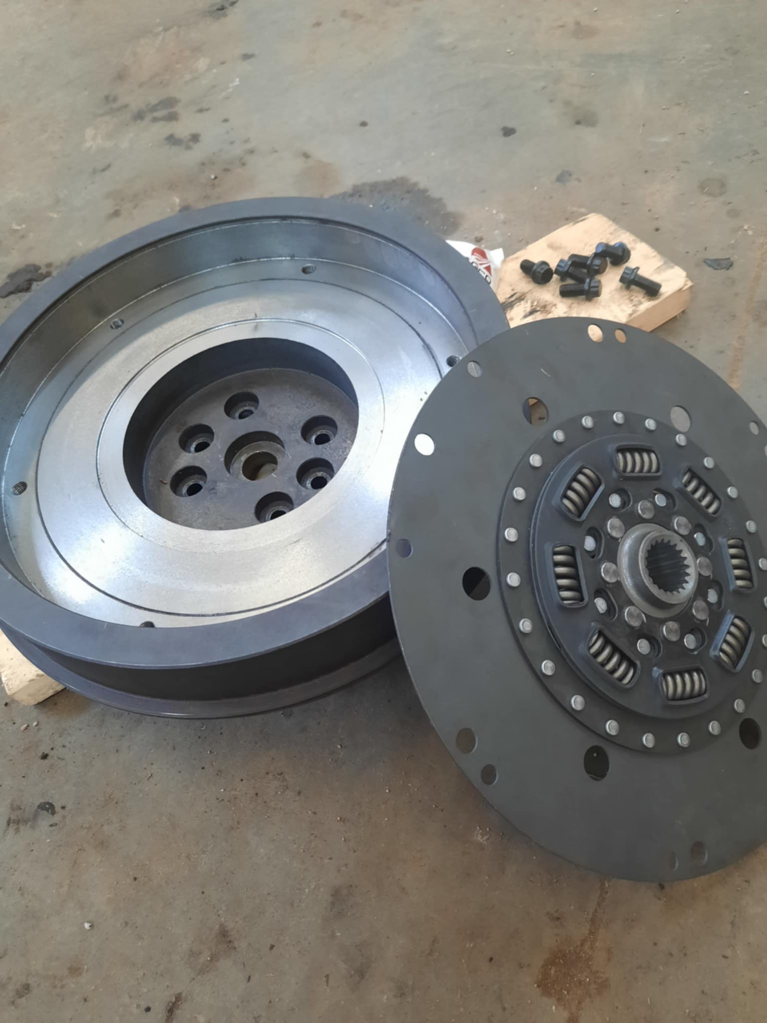

Torque damper swap is what ive been going with on our tractors. Did one on the 7095 when I built it and it worked great! Did the 8050 with one from a guy on Facebook that has them made for his cummins conversions. Had the flywheel turned to fit and works great!

  Is that thicker gauge steel surrounding the springs and attached to the pto hub then stock?
  If so how do I get my greasy hands on it.  PM contact info if you like.
Peterson View Drop Down
Joined: 05 Mar 2011
Location: Westboro, Wi
Points: 872
Post Options Post Options   Thanks (0) Thanks(0)   Quote Peterson Quote  Post ReplyReply Direct Link To This Post Posted: 29 Apr 2025 at 9:18am
It's for a international, but with the power shift hub in it.
https://www.facebook.com/share/1EHJTNfcBg/
This is the guy I got it from. Can do power shift or power director.
