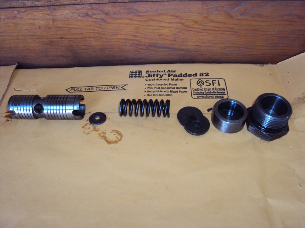

Here are remaining questions from me before I start.  Is it best to leave the pump on the tractor?  Do I need to be ready for parts to drop out of the bottom when I remove the plug or can I take them out one at a time?  Do I get a rush of hydraulic oil once the plug is removed pushing parts out at the same time?  Once everything is removed, do I need to pump air into it to clean out foreign material or something else?  Does this process create an air pocket that needs to be cleared?
When I get the spool out, I may have some further questions on polishing.  I have to finish my 500 loader cylinder rebuilds before I tackle this so it may be a few weeks before I can report back unless I prioritize this first.

To polish mine I took a 3/8 or 1/2 wood dowel about 8 inches long and cut a slot in one end about as deep as a ribbon of Emory cloth is wide. Fed the Emory cloth threw the slot and put it in a drill and polished the barrel.
Nice tip.  So you were polishing only the inside of the barrel and not the outside of the barrel?

Thanks Lynn for the pic.  I am wondering if the shim and one of the washers are optional from the parts diagram.  Looks like the top portion of the parts did not come out of the pump.  I only see the bottom portions of parts.  Still curious if the pump stays on the tractor or not when this is done.
Polish the surface that the left most piece in Lynn’s picture travels against.

Isn't that the inside of the pump housing then?

Leave the pump on the tractor. No need to remove the top cap. The orifice disc with the small hole can get restricted and cause problems. The spool should slide in and out of the bore easily. Polish both surfaces the best you can and flush the bore before reassembly. You may have to devise something to pull the spool out if it is stuck. I would also be checking the left hand filter and screen to be sure that they're good.
Thanks Lynn for that detailed explanation.  It sounds like my problem should be obvious once I disassemble.  I might tackle it this weekend since it may not take that much time to do.  I will report back my findings.

I never got lucky enough to be able to leave the top cap on. For me that spool was firmly stuck.
