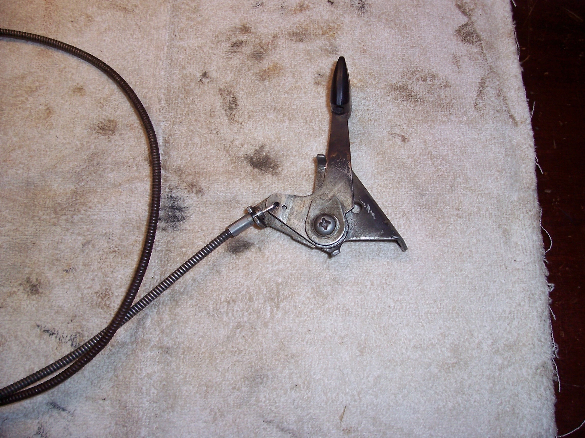

Post Options Post Options   Thanks (0) Thanks(0)   Quote V2Inc Quote  Post ReplyReply Direct Link To This Post Posted: 16 Nov 2016 at 4:06pm
I measured the cable length, it's about 51 inches.  I wouldn't think the cable length would be a big problem so I'm inclined to think the throttle assembly is different.  Also, the way the cable attaches to the assembly may be different.

Post Options Post Options   Thanks (0) Thanks(0)   Quote V2Inc Quote  Post ReplyReply Direct Link To This Post Posted: 16 Nov 2016 at 4:19pm
Allis Chalmers 616 w/60" Blade, 48" Rotary Tiller & Plow - Cool Man Stuff

Post Options Post Options   Thanks (0) Thanks(0)   Quote V2Inc Quote  Post ReplyReply Direct Link To This Post Posted: 16 Nov 2016 at 4:21pm
Don't know why my photo is so big, I just downloaded what was on my computer.  If can help me out with loading smaller photos, let me know.
