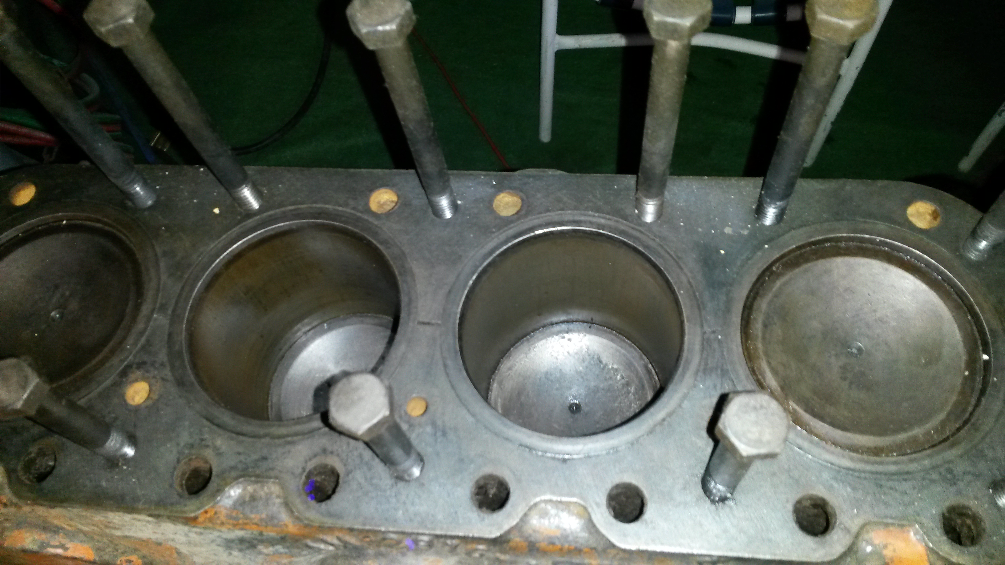

Well I don't know what happened, I tried to post 6 or 7 pictures and only one posted and it is very zoomed in. This picture shows the cracks between the cylinders. There is also a crack on the outside of the block that runs almost 3/4 of the way across it on right side of the block.

I wouldn't worry about the cracks between 2-3, and 3-4, they get covered by the HG.  The one on the outside of the block is the worrysome one, if it is into an oil gallery. If you can draw a vacuum across the oil gallery, in the block, and it holds,  its not into the oil gallery(yet)  Looks like some water or ping damage to jug #3, too...

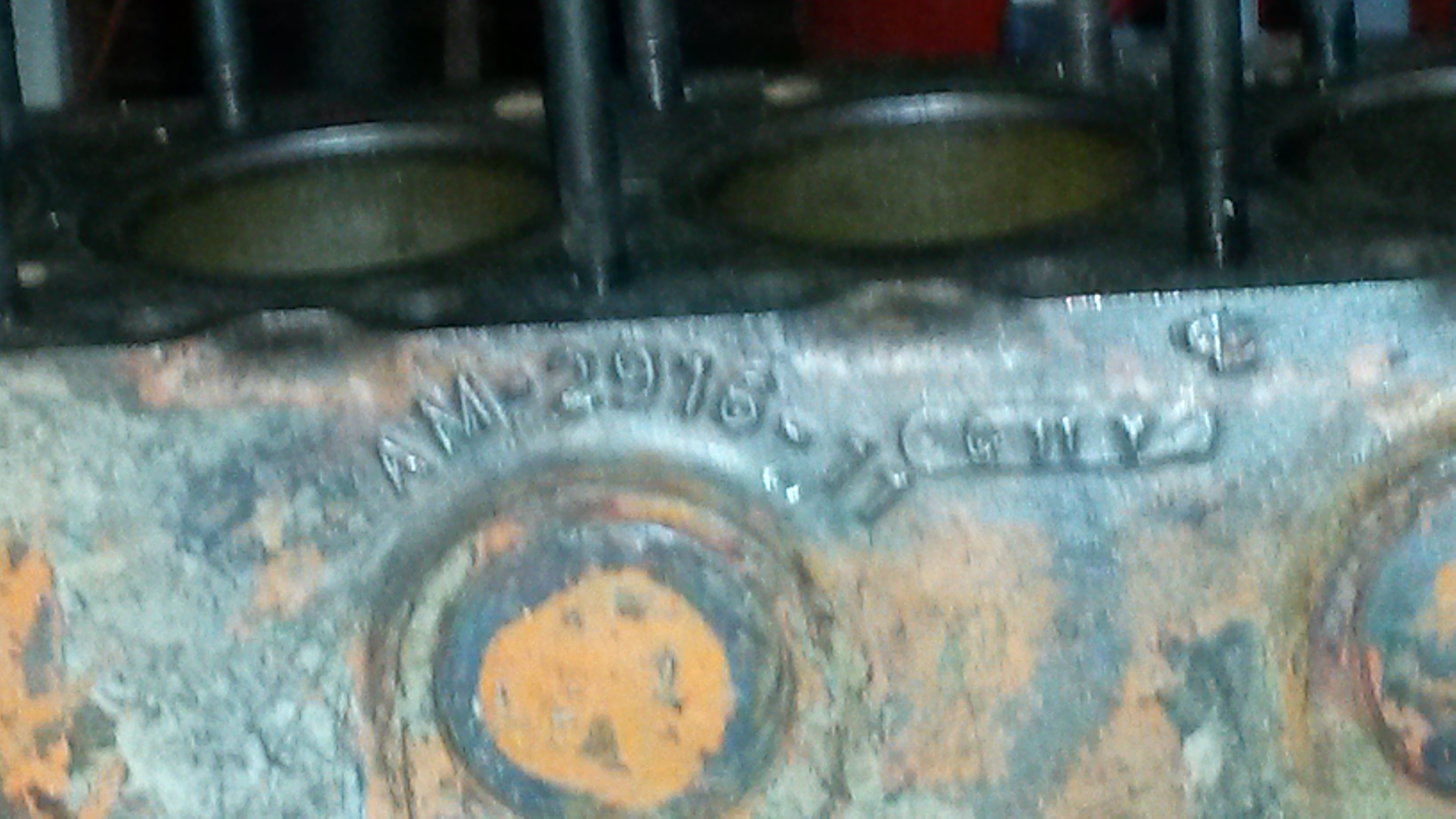

Here is the pictures I took the other day
