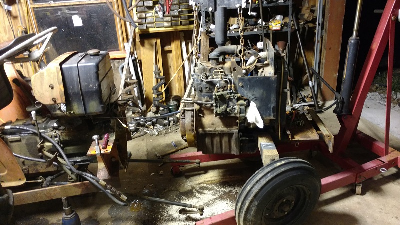

Post Options Post Options   Thanks (0) Thanks(0)   Quote alan-nj Quote  Post ReplyReply Direct Link To This Post Posted: 20 Feb 2017 at 6:02pm
i changed my clutch last year.  here's a pic of when it was apart.  i used jacks on the back, hoist on  the front which allowed me to roll it apart
