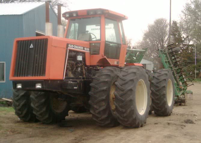

My nephew's 4dub quit working in the field last week. Won't move and power steering is gone. He took hydraulic pump off and the splines on the shaft are wore down so it does not catch splines in the tractor. No parts available and none at salvage yards. Local dealer told him he should just salvage it. It's a really nice tractor to do that with. He doesn't want to salvage it. Any suggestions and help would be very appreciated. Thanks, rrhead(SD)
Edited by rrhead(SD) - 18 Nov 2017 at 4:37pm

First off, I wouldn't salvage it either. That's a good looking tractor, and I'd love to have one someday!
I've heard from several guys the articulateds are hard to find parts for. I don't understand why?? If parts for the 7000/8000 are everywhere, why not these?
I'm no expert, but it sounds to me like something must have been loose for the splines to wear like that. Would it be possible for a machine shop to build a new shaft?

I have 2 4W305s.  I believe I have a NOS shaft that I bought to put in the pump.  Went to local hydraulic shop.  They were able to have a stacked pump assembly built that allowed me to hook up all the lines and manifolds that are bolted to those pumps.  That was 10 years ago though. If you tear that pump apart to change the shaft are all the seals available?

I would think someone could rebuild the shaft, it's the inside gear that is splined that would be the more difficult one. rrhead(SD)

we have 6 4w305 -2 4w220 -2-7580 3-8550 go and get a shaft made and you will be money ahead.

I have new: shaft 70275649 and seal kit 70273974.   Effective SN. 1174

That can be fixed. Know of a guy in WI that just had the same issue. Had shaft made. Good as new. Please do not salvage that nice hard to find AC.

If thought A-C improved that design over the 75-85 series 4wd's. but evidently not. Had it happen to my 8550 many years ago, going along fine knifing in NH3 and just like that nothing. Fixed it right were it died, at that time I bought a new shaft and rebuilt the pump and found a like new gear. The problem is that the shaft fits in a dry socket with no lubrication, A-C should of crossed drilled some oil passages to allow for some lubrication of the shaft. When you put it back together use plenty of anti-seize. After that I would remove the pump now and then and relube the splines. Good Luck, Mike

Thanks for all the comments. The tractor had no symptoms before this happened. Just like Mike's, it stopped in the middle of the field. I do like Mike's advise of putting anti-seize on when reinstalling and then doing it again. We have opportunity to get shaft and seals. Working on that and finding someone to work on gear in tractor. Thanks again, rrhead(SD)

If JP has the correct shaft, I would suggest buying it, and immediately taking it to a reputable machine shop and have them match it, making several at a time. With CNC machine work being what it is, making several probably won't cost much more than one plus a few bucks. Then put the original back in oilcloth and stored in a dry place.
