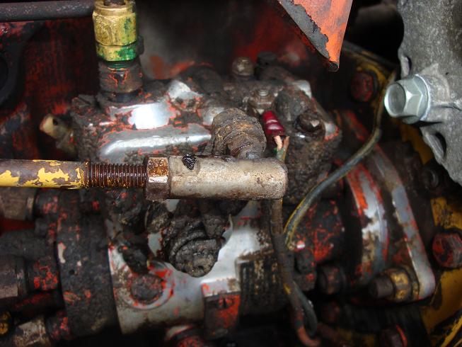

I checked the voltage at the injection pump electric line to the electric solenoid stud and it is well over 12volts.  This weekend, my son helped me get it running for about 5 minutes.  He turned the ignition switch while I tapped the solenoid housing with a metal object.  It fired up, ran for a while, then shut down suddenly like I had turned off the key.  Now, I can't get it to do anything.  Do the solenoids just quit working on these over time?  Is this something I could fix without removing the whole injection pump?  If so, do I just remove the 3 bolt governor housing, return injector fuel line, & 12v wire to get at it??  Its really dirty all over this area.  I have tired to powerwash it but some of the dirt is stuck like concrete.  Below is a picture after I washed it.  Ive always understood to keep it clean around diesel fuel injection pumps.  Is there a solvent that anyone can recommend to aid in cleaning this up before I start repairs?  Any advise would be helpful - Thanks.

Trichlorethylene is good if you have any (I still have a few gallons). I use aerosol brake cleaner like Weaver with the spray hose it tends to blast off stuff. Screw drive method is always safest as long as electric is disabled. I also use a wire engine cleaning brush on my air drill for nooks and hard to reach spots. For this cooked on crap I would soak some shop rags and let them sit there to see if it would loosen up, I have also used a hot air gun at times for tar. Looks nasty!

the solenoid in the pump could have failed, or the metering valve could be very sticky due to old fuel. clean off outside of pump with brakleen, and remove top cover of inj pump. solenoid is in the cover. look in the pump once cover is removed and see how clean it is and free the metering valve/gov linkage all moves.
