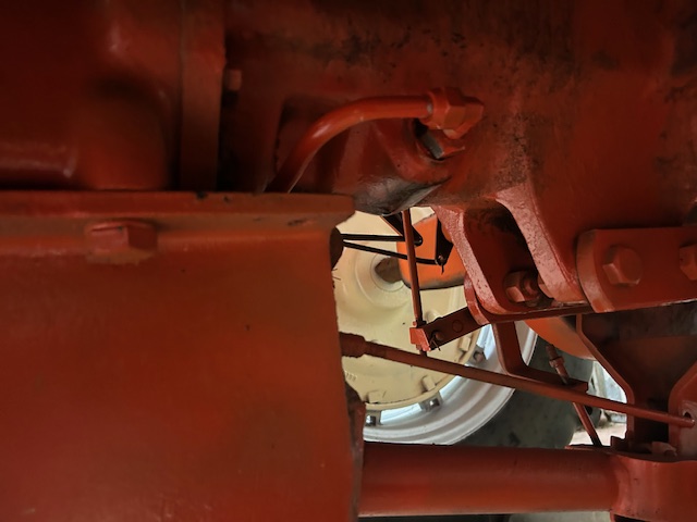

Temporary fix has been to connect the Hydr & Tran/Diff compartment by going from front to rear drain plugs with a hose.
 I worked on clutch in tractor that had been connected that way to get thru planting.
 They'd removed 1/2" npt plug in torque tube & installed a 90 and reducing bushing 1/2 to 1/4", drilled & tapped tran plug to 1/4" npt, installed brass 1/4" 90 and ran a 1/4" hose between them.
 F Y I; A word of caution the Tran plug is directly above the drawbar, and there's not much clearance between drawbar and the 90.

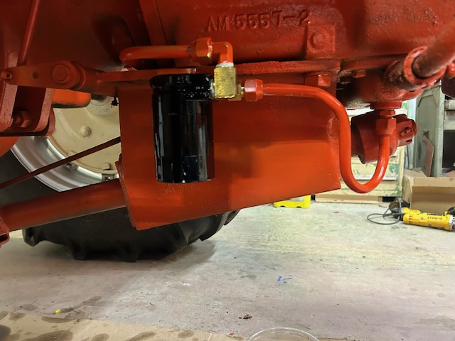

Post Options Post Options   Thanks (0) Thanks(0)   Quote DPKII Quote  Post ReplyReply Direct Link To This Post Posted: 20 Jun 2024 at 9:21am
I recently did based on the pictures in the post above after finding oil dripping everywhere on the drawbar after about an hours use.  I originally thought it was coming from the rockshaft as it was dripping from there but now I am thinking it may be coming from the lift cylinders.  I installed the catch can to eliminate any metal shavings finding there way from transmission to hyro reservoir.  I have a strong magnet in the bottom of the catch can as well. Wanted it semi-permanent as I will not be able to try spitting the tractor any time soon. Never split anything as large as the 190.
