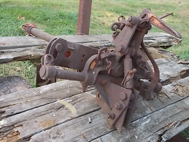

Post Options Post Options   Thanks (0) Thanks(0)   Quote PaulB Quote  Post ReplyReply Direct Link To This Post Posted: 14 Nov 2016 at 5:19pm
This is a main frame for a 70 series and it has part of the Auto-Spinner on it. There's a bracket that mounts on the tractor PTO shield for the point to swipe by and that trips things. On the ones I've used behind a CA or WD45 you're right there, just remember to wear GLOVES, those shares can get sharp!  This is FREE to the one that comes to get it.

Post Options Post Options   Thanks (0) Thanks(0)   Quote HudCo Quote  Post ReplyReply Direct Link To This Post Posted: 14 Nov 2016 at 8:47pm
mine has that auto spinner on it and it worked good on the  d17 but i think that i am missing somthing on the tractor side to make it work on my wd45.       some one have a picture of that ?

Post Options Post Options   Thanks (0) Thanks(0)   Quote Eldon (WA) Quote  Post ReplyReply Direct Link To This Post Posted: 14 Nov 2016 at 8:55pm
Yes I would like to see the tractor bracket also....
