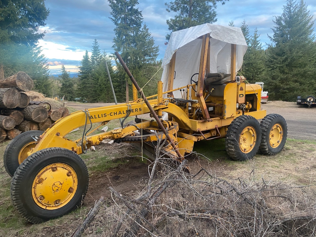

helping out a neighbor that has a 1961 Allis Chalmers DD3365 grader
the 2 speed gear box lost a gear, looking for a replacement, its the gear that has the fork selector that allows you to shift to low or high, the low side is damaged,
talked to meridian equipment in Bellingham, WA, they referred me to Wellerts in West Salem, Ohio. Talked to a guy there, says he needs a part number.
Looking for a part number, this is what the machine looks like and this is what the gear looks like. Trying to find a parts manual or at least the page I need to get a part number for this gear.
16 tooth external 3” diameter
13 spline internal 1-3/4” diameter
Has a slot for the shift fork
I understand that repair is a possibility, just a lot of time in labor to do it, and that will be my last resort.

update, i found out the part number of the gear we are after is 70674804
i contacted wellerts in ohio and gave him the part number, he was busy and will get back to me
serial no. of machine is D-6244
any other leads out there?

The transaxle was made by Clark so the drop down box was probably made by Clark as well.

Not that this will likely help your parts search much!
IIRC the trans axle was also used in a small Galion grader - might have been model 503.  No idea of how much else of the gear train.
