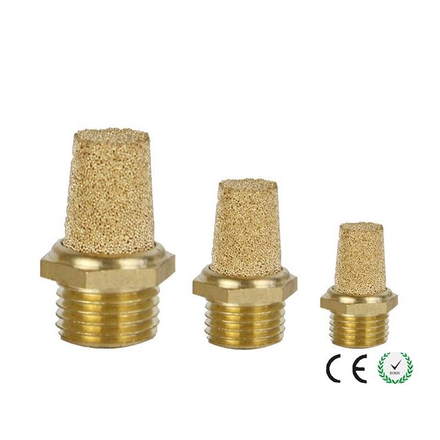

I think I've got it figured out how to turn the double acting ram on the haybine to a single acting ram and use it that way, then have a switching valve right behind the seat so I can control height and transport/cut ram in a fairly efficient manor. Thanks guys! Sorry I haven't got pics yet, but if you've seen one, you've seen em all! Haha. Soon tho
Post Options Post Options   Thanks (0) Thanks(0)   Quote CTuckerNWIL Quote  Post ReplyReply Direct Link To This Post Posted: 09 Sep 2016 at 11:47pm
Just take one hose off and put a sintered muffler in it's place

Post Options Post Options   Thanks (0) Thanks(0)   Quote pigpenH Quote  Post ReplyReply Direct Link To This Post Posted: 10 Sep 2016 at 7:27am
CTuckerNWIL, basically the same thing as I planned but was going to use a oil/hydraulic filter, whichever fit. Any pros or cons on using either one? Thanks for the tip! Didn't think of them...

Post Options Post Options   Thanks (0) Thanks(0)   Quote CTuckerNWIL Quote  Post ReplyReply Direct Link To This Post Posted: 10 Sep 2016 at 11:16am
You don't need a filter, just a vent that will keep dirt from getting sucked in when the cylinder goes down. You could even drill a small hole in a pipe plug but it won't filter much, just keep out any big stuff. Heck, drill a 3/16 hole and fold a pipe cleaner over a couple times to plug the hole Wink
