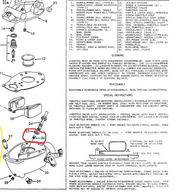

These G tractors use the TSV 13 carburetor. It seems there are different versions though. Some use a power jet, idle jet, etc. The carburetor I have has been taken off and cleaned a few times, and I believe someone left the power jet out by mistake.
Can someone verify that the 1952 G model carburetors have the power jet in them? And, if so, where can I get one?
My carb has the adjustable main jet on the bottom of it, with the main nozzle meeting it on the inside, but there is a gap between them, and this is why I am thinking the power jet is missing.

Allis G carb....
https://www.carburetor-blog.com/wp-content/uploads/2022/05/TSV-13.pdf
Points: 86774
Post Options Post Options   Thanks (0) Thanks(0)   Quote steve(ill) Quote  Post ReplyReply Direct Link To This Post Posted: 27 Jun 2025 at 7:54pm
#49 the POWER JET is made into the PLUG...... What is plugging that hole ?

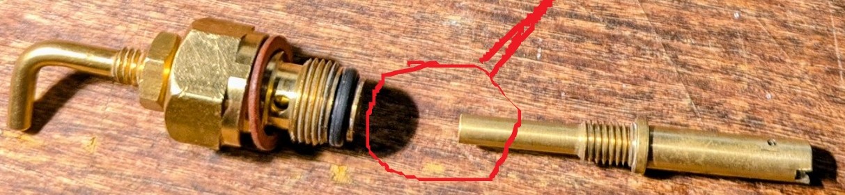

This is my actual main jet and nozzle. I found a diagram that says there is supposed to be a power jet in-between these two. If so, mine is missing.
cabinfourus View Drop Down
Joined: 03 Jun 2025
Location: Asheville, NC
Points: 17
Post Options Post Options   Thanks (0) Thanks(0)   Quote cabinfourus Quote  Post ReplyReply Direct Link To This Post Posted: 12 hours 13 minutes ago at 3:16pm
I circled it in red.
