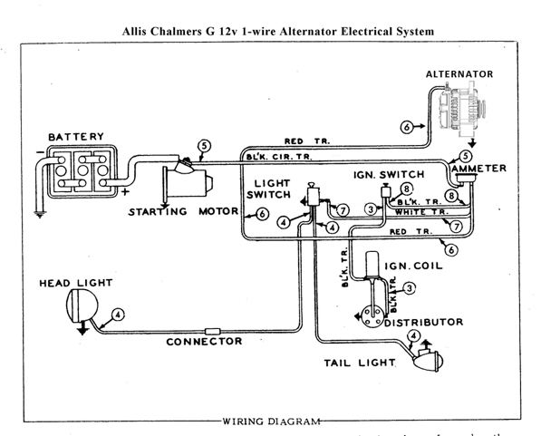

Here is a wiring diagram for a 1 wire conversion on a G. Check your wiring against the diagram. Forget about the original 6v system. The points and condenser are fine. Did you replace the coil with a 12v coil? Get a standard or blue streak condenser or maybe try the old one. Quick enough to do.

Post Options Post Options   Thanks (0) Thanks(0)   Quote cabinfourus Quote  Post ReplyReply Direct Link To This Post Posted: 11 hours 37 minutes ago at 1:14pm
Thanks, I will go over the wiring again this evening.
It did have a new 12v coil but someone wired it backwards, so I ordered another one and will replace it tomorrow.
