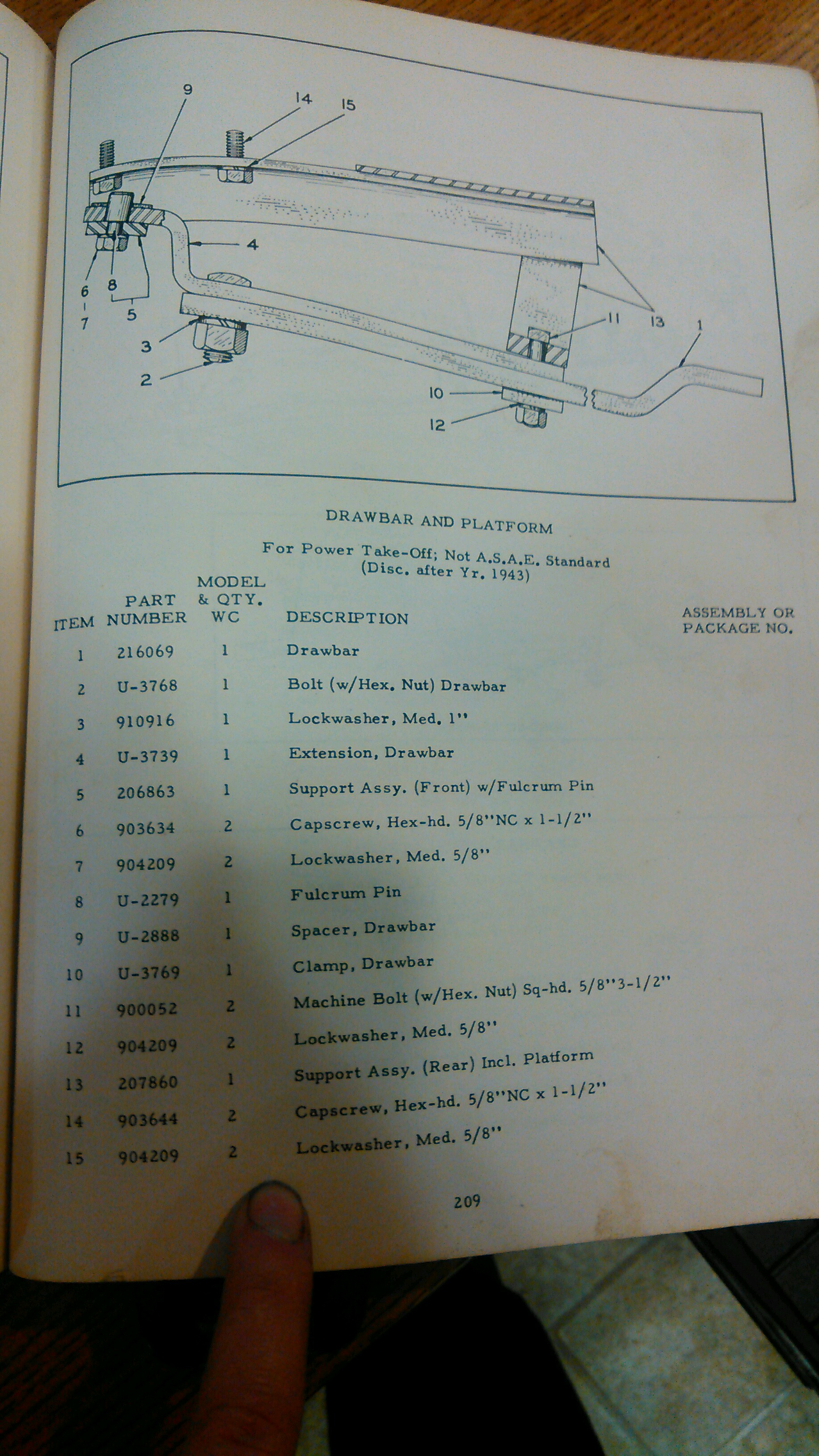

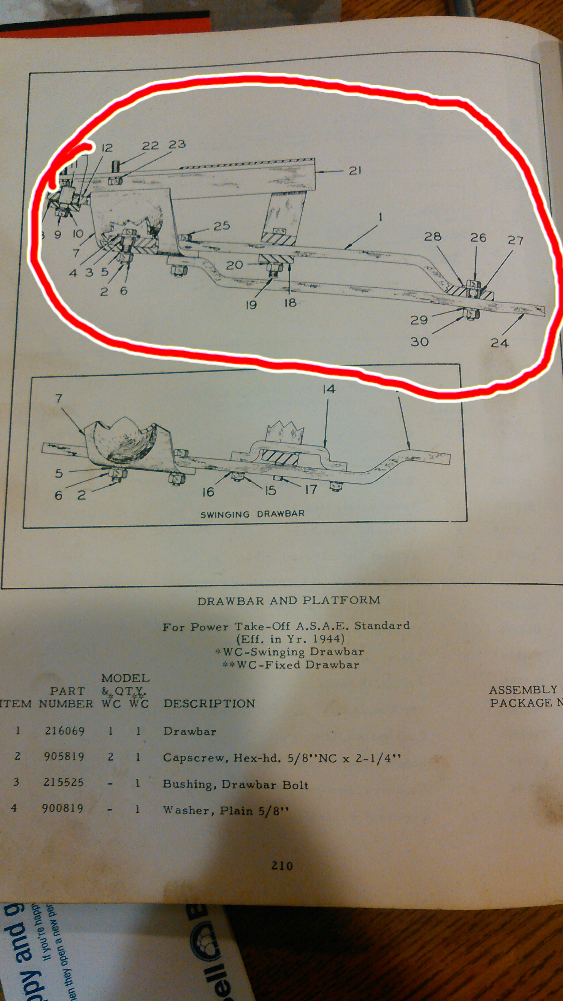

Post Options Post Options   Thanks (0) Thanks(0)   Quote a jossund Quote  Post ReplyReply Direct Link To This Post Posted: 31 Dec 2016 at 7:38pm
Here is the page out of the parts book showing the hitch I have.  While it says after 1944, it was previously mounted on a 1937 ( im suspecting a later replacement?)

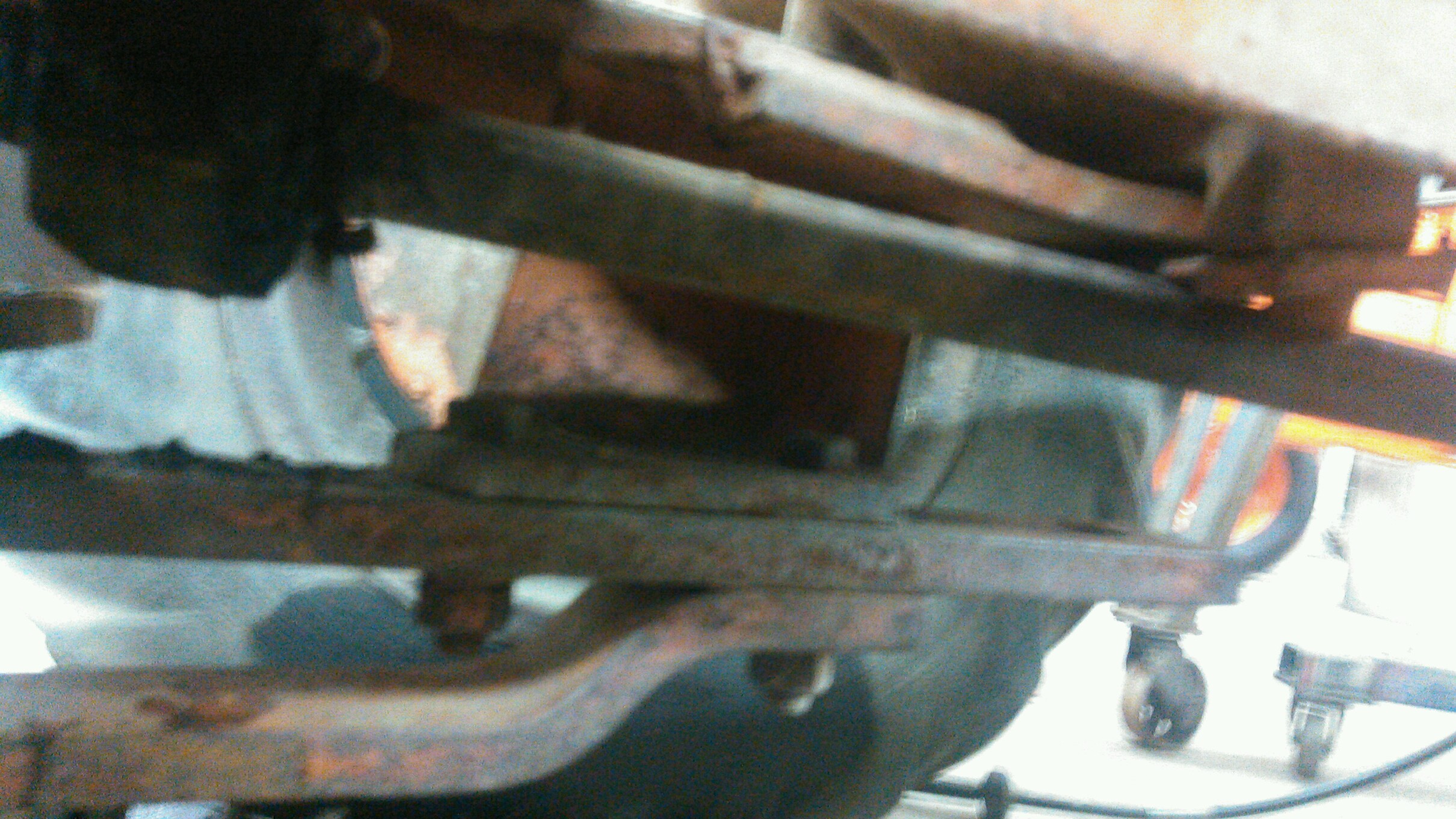

Post Options Post Options   Thanks (0) Thanks(0)   Quote a jossund Quote  Post ReplyReply Direct Link To This Post Posted: 31 Dec 2016 at 7:40pm
here is the hitch im working with

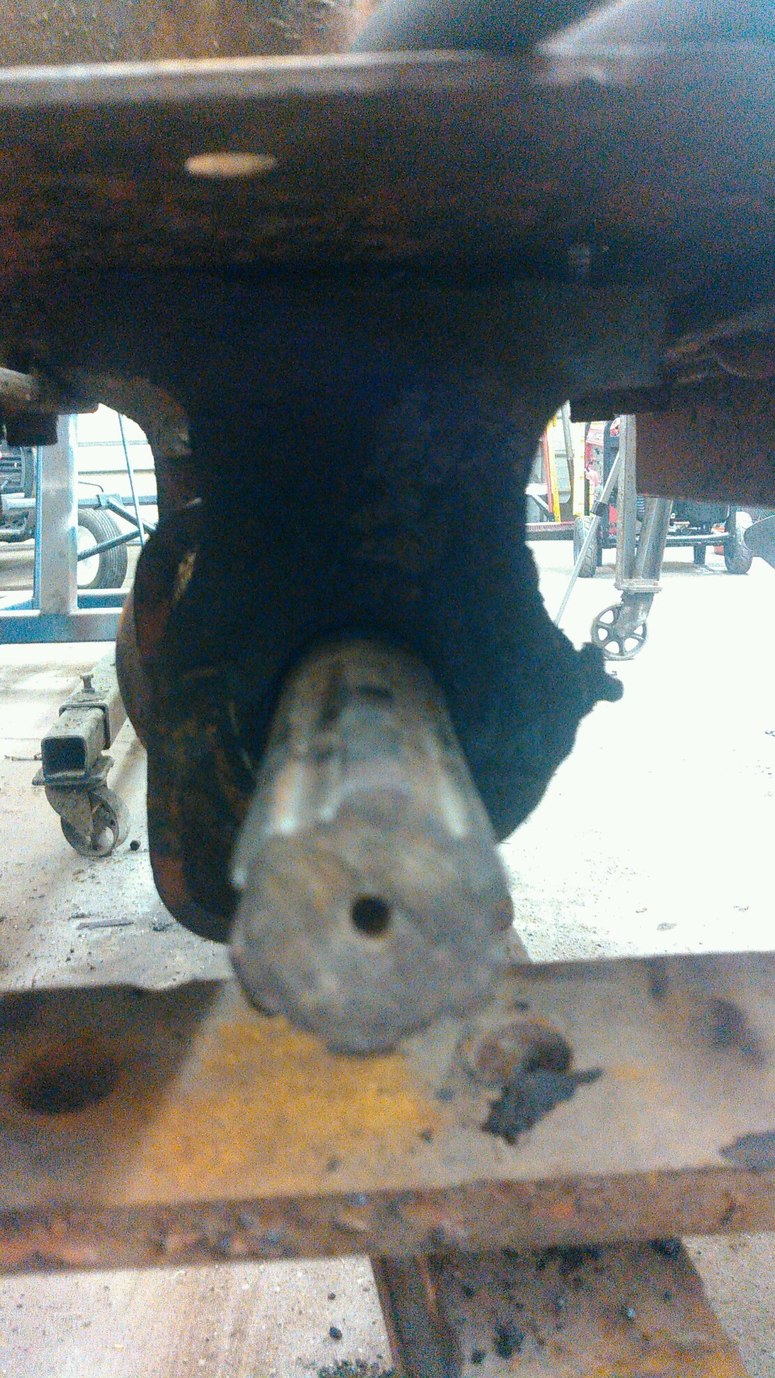

Post Options Post Options   Thanks (0) Thanks(0)   Quote a jossund Quote  Post ReplyReply Direct Link To This Post Posted: 31 Dec 2016 at 7:49pm
in regaurds to the PTO hanger bearing, where the gap is here between the pillow block and the platform, should there be a spacer or the shield?

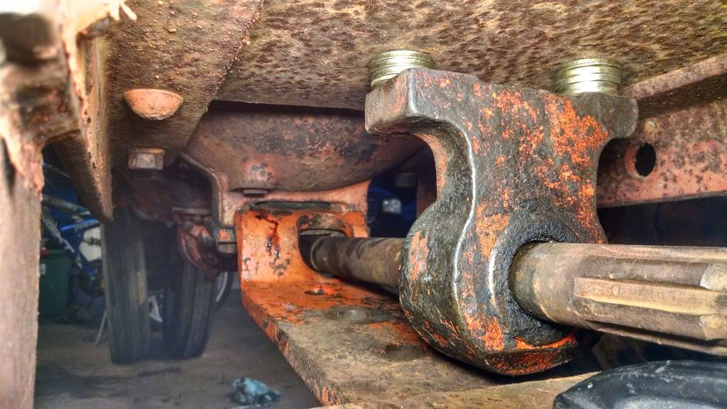

Post Options Post Options   Thanks (0) Thanks(0)   Quote littlemarv Quote  Post ReplyReply Direct Link To This Post Posted: 01 Jan 2017 at 6:22pm
I think there are two drawbar setups? One is a "C" shaped thing, and one like this, where the shaft actually goes through the drawbar. Here is what I did to make it work with what I had. If anyone knows what is supposed to be in there instead of the washers, let us know!

Post Options Post Options   Thanks (0) Thanks(0)   Quote a jossund Quote  Post ReplyReply Direct Link To This Post Posted: 01 Jan 2017 at 7:20pm
Thanks for the reply! your drawbar is the other style in the parts book, thanks for the good pic! thats what im thinking ill have to do with my pto bearing to keep the shaft from rubbing, unless someone can let us know how there suposed to be

Post Options Post Options   Thanks (0) Thanks(0)   Quote a jossund Quote  Post ReplyReply Direct Link To This Post Posted: 04 Jan 2017 at 8:08am
Thanks for the help guys, my hitch (it’s hard to see in that small picture) is the ASAE spec hitch with the C shaped piece mounted to what Allis called the rigid drawbar in the parts book.  In the book it says effective in 1944 but given oldways tractors both have the same hitch perhaps it was available earlier? JoeM(GA) , that’s similar to my hitch except that is what Allis called the swinging drawbar, thanks for the pics! Does your hitch touch the drain plug in the rear end when it is straight back?  Also is your rear hanger bearing for the PTO  bolted directly to the platform?  Thanks!

Post Options Post Options   Thanks (0) Thanks(0)   Quote JoeM(GA) Quote  Post ReplyReply Direct Link To This Post Posted: 04 Jan 2017 at 8:38am
Andrew, mine misses the plug, and there was nothing under my flange, it was bolted directly to the plate
