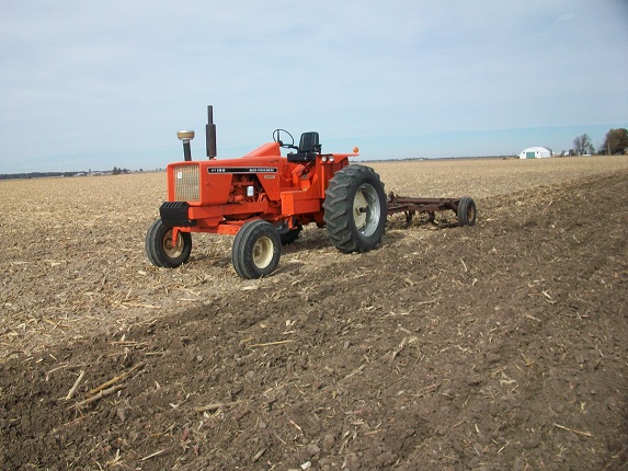

I bought this tractor after it set for a few years with a full tank of bio-fuel and, I can drive it more then a few feet under load without it plugging.. any idea's how to go about cleaning out the tank ?
