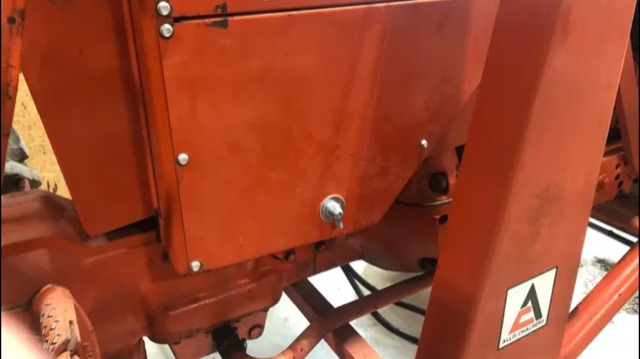

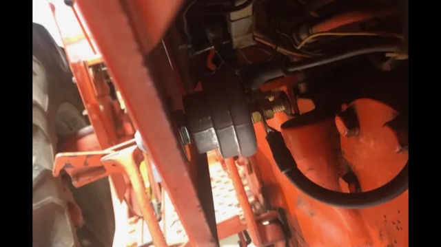

I added this battery disconnect switch to my 170. Works great.   It is a Grote 82-2103.   I put it on the Right side of the tractor because of the way the battery cables were routed, I would recommend putting it on the Left side, that’s where my gas shutoff is and the easier side of the tractor to climb on and off.
