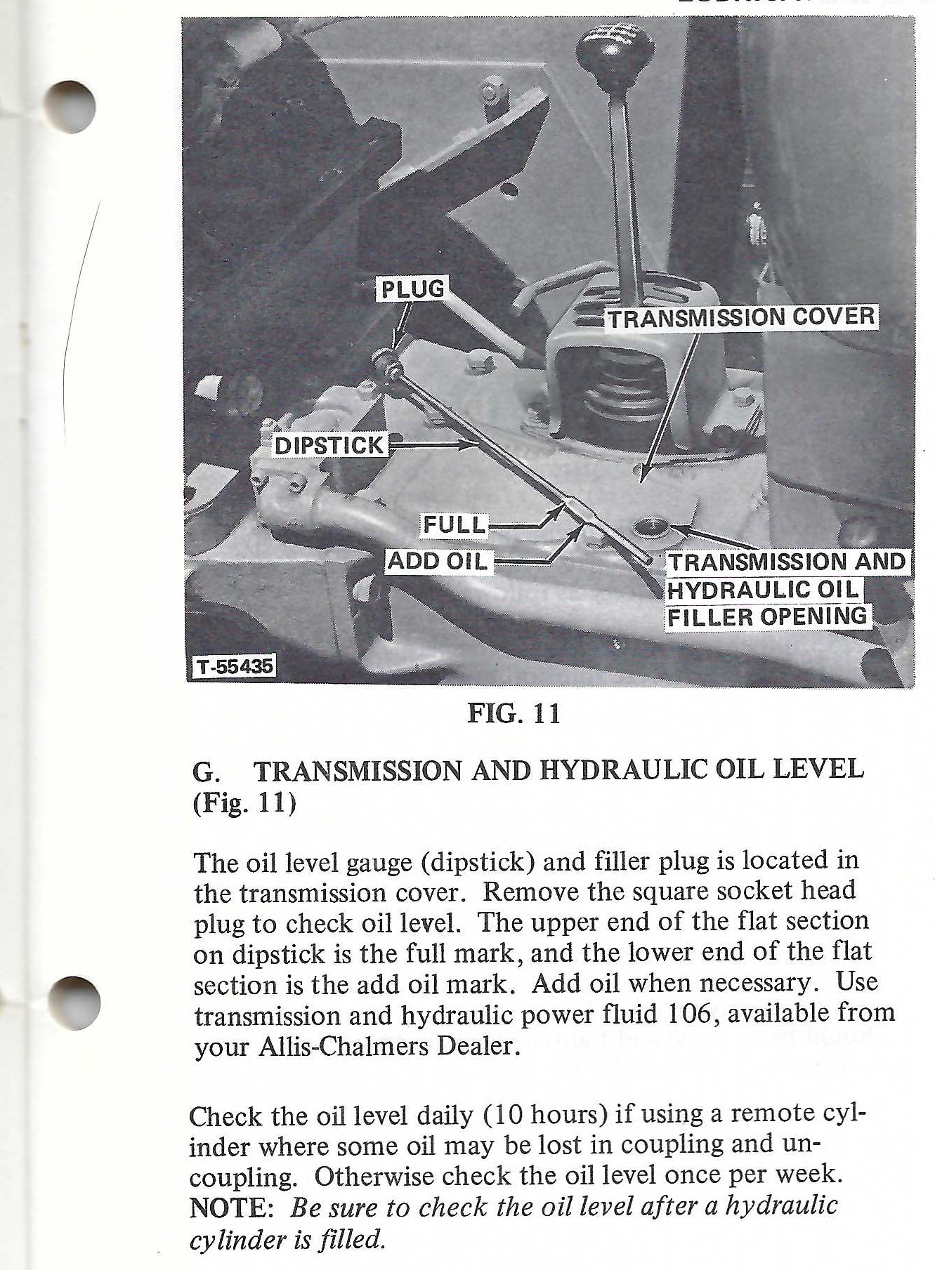

My user manual shows to remove the hydraulic/transmission screen to clean every 200 hours. Oil Filter at the right front of the tractor should be replaced along with the oil every 300 hours. Takes 29 quarts of AC 106 transmission/hydraulic oil.
I would do that service first and see if that resolves you issue, if not let me know. Drain plugs are at the rear of the tractor underneath the transmission and hydraulic systems.

The dip stick is to the right of the gear shift, I’m sure you may already know that. 3/8” wrachet fits it.
Points: 5402
Post Options Post Options   Thanks (0) Thanks(0)   Quote AC720Man Quote  Post ReplyReply Direct Link To This Post Posted: 15 Jun 2021 at 8:52pm
You said without a good dipstick? What do you mean by that? The dip stick is attached to the filler plug? If you don’t have a dipstick attached to it then good chance its in your trans tearing stuff up.

I checked by the large hex head plug on top. Did I do it wrong?
Points: 5402
Post Options Post Options   Thanks (0) Thanks(0)   Quote AC720Man Quote  Post ReplyReply Direct Link To This Post Posted: 15 Jun 2021 at 10:01pm
The plug you want has a square inward head, my 3/8 ratchet wrench fits right into it so you can loosen it and tighten it with it. When you unscrew it the dip stick is attached to it. Dipstick is probably 10” long I’m guessing. If its low, your pump may have lost its prime. I would change fluids and filters first if it has been over 300 hours. There is also a hydraulic/transmission screen that needs to be cleaned. It is in front of the seat to the right. Remove 4 nuts that hold the cap and remove it. Gently pull the screen out and clean it in solvent. Also a magnet attached to the cap, clean any metal fragments from it. These small things to do will most likely have you working again.

The high mark on the stick is 9.25 from the head on the plug, low mark 10.25.
If you have a hex head plug of some sort, then the original got lost.
I think there was the Basic model 160 that didn't have this dipstick, but instead had
a horizontal plug, perhaps under the right foot board.
