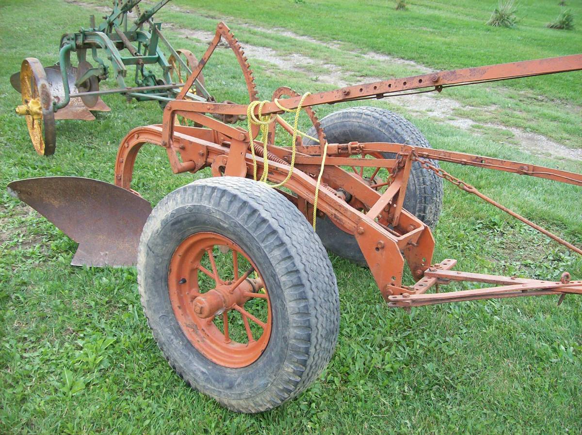

Guys my 11 year old son and I bought an Allis c and this plow, can you tell if this is an alllis plow and will the c pull it? Thanks

That is an Allis Chalmers Series 1 plow. Can't tell if has 16" or 18" plow share, but either way your C will pull it with no problem.

I agree that that is a #1 Allis plow.   Either it's a very late one (because of the rubber tires) or someone converted it from steel!  If it's a early one it should have "Allis Chalmers name cast into the beam.   Also of the many #1's that I've seen I've never seem a 18" shear I know that they are supposed to exist but the bulk of them must have been 16".    The curve of the mole board is so close to the infamous Case plow that one cant help but wonder if the same party didn't design them both.   They just seem to roll the dirt & crumble it better than most others!!

Guys thanks so much for your information, we don't have it picked up yet, but I'll check the beam to see if it's stamped, and hopefully find an operators manual on it, make sense with the spokes that it may have been converted to rubber, some plows ive seen on rubber would have a solid rim, either way the rubber will be nice for loading and unloading on a trailer.

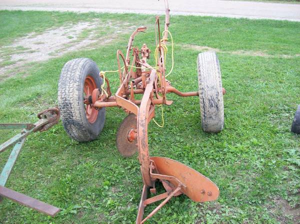

Hers the back of plow

Ok we got the plow home, it's a 16", it DOES have allis chalmers stamped on the main frame. Question! None of my clevises seem to fit in the hitch, does it take a special style? Not sure it's latching properly, but I'm thinking it's just the clevis? Thanks
