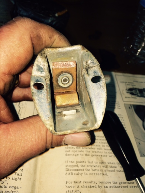

I took mine apart and filed the contacts until they were smooth and fully, well, contacted each other.  If there's enough left of the switch, that's an option.

Post Options Post Options   Thanks (1) Thanks(1)   Quote chaskaduo Quote  Post ReplyReply Direct Link To This Post Posted: 26 Sep 2019 at 5:55pm

I had a similar problem.  Removed the old switch, cleaned all the contact points, and put it back on.  Has been working fine for several years now.

The Cole Hersee looks identical to the one I have minus the side terminal. Is that a positive or negative terminal? I could try to clean up my old one, but one problem is the spring and push button is wore out, and binding.

I can see if you're 'whimpy' about pushing on the rod, you'd get a LOT of burning and pitting of the contacts which of course makes it worse the next time you use it. Push hard and hold.... would be my advice.
It's also important that both pieces mate very well ! ANY rough spots and arcing will occour, again , pitting the pieces.

I have an Allis C and have had problems with the factory original starter switch. I was able to clean it up by sand blasting it. You must remove it completely to get it into the sand blaster.
