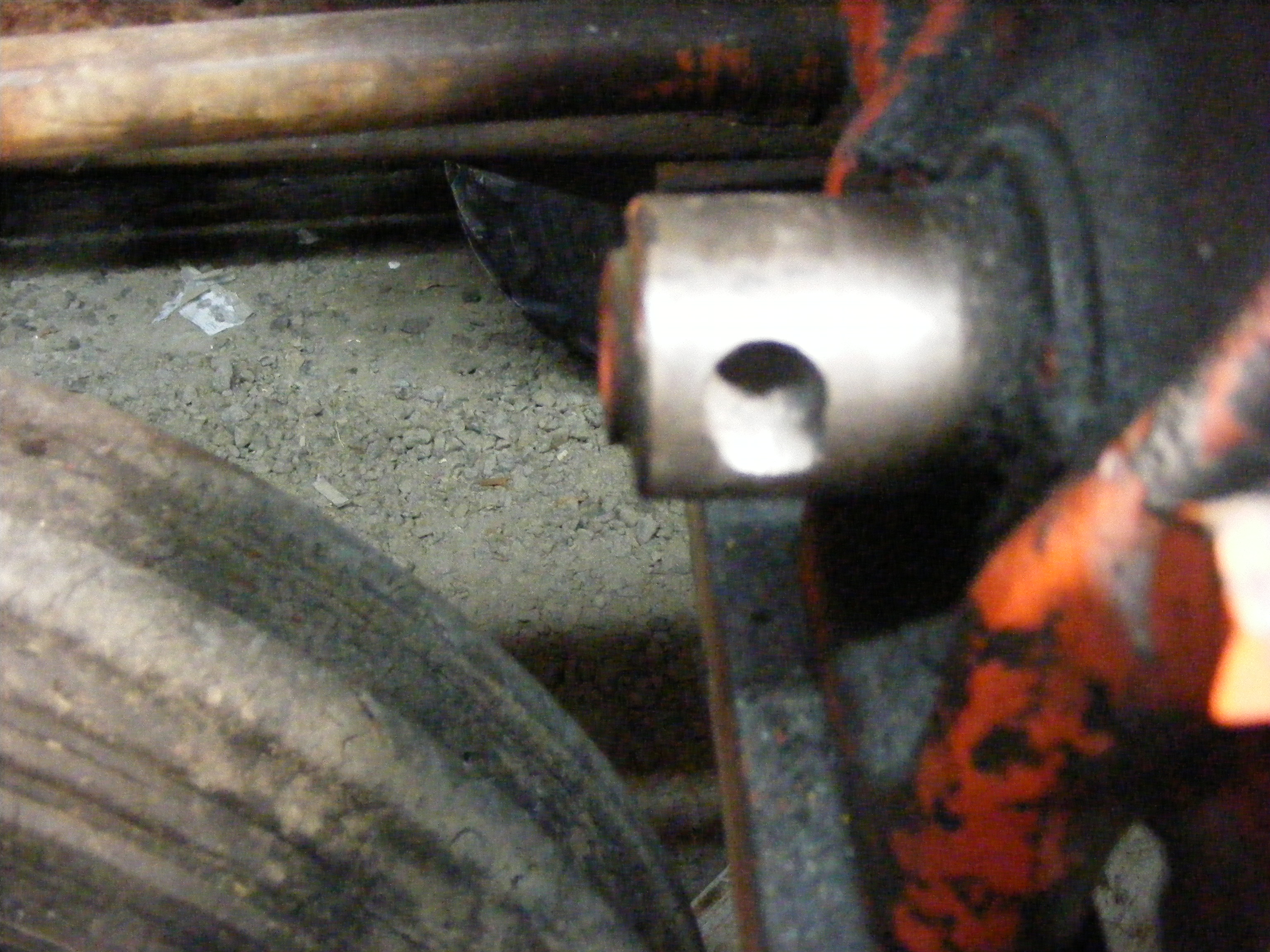

Posted By: hamman01
Date Posted: 12 Jun 2012 at 6:46am
Posted By: hamman01
Date Posted: 12 Jun 2012 at 6:47am
this is the bolt that I am dealing with. I almost have this picture thing figured out. I will have this off today.
Posted By: hamman01
Date Posted: 12 Jun 2012 at 6:50am
There is another flat spot on the opposite side of the pulley, however there is no hole or bolt of any kind in it! I thought there shold also be another set screw.

Posted By: hamman01
Date Posted: 12 Jun 2012 at 8:32am
As soon as I get the rest of the morning ritual done here in the house I am going to try to get it off. I will take more pics and try to ge them to post. I should of looked at this a lot closer when it was out of the tractor. I t would of been easier while hanging from the chain fall. I never noticed that the ears were broken off until I went to turn the crank to tighten the flywheel bolts.

Date Posted: 12 Jun 2012 at 11:06am
I haven't been able to get the bolt out. Cut it square and tried sockets. Just stripped. We cut a nice slot in it and it just stripped out.  Now a question. Is there a key under this bolt or is there an indent in the crank end where the bolt is tapered and fits into?  My next try is to cut the bolt flush with the pulley and try to drill it out. I don't want to screw up the crank by drilling into it. Thanks.

Date Posted: 12 Jun 2012 at 1:02pm
It should have a tapered hole in crank.The taper bolts/setscrews all over the tractor have same taper.Starter lock,brake/clutch cross shaft,steering arms on wide fronts etc.

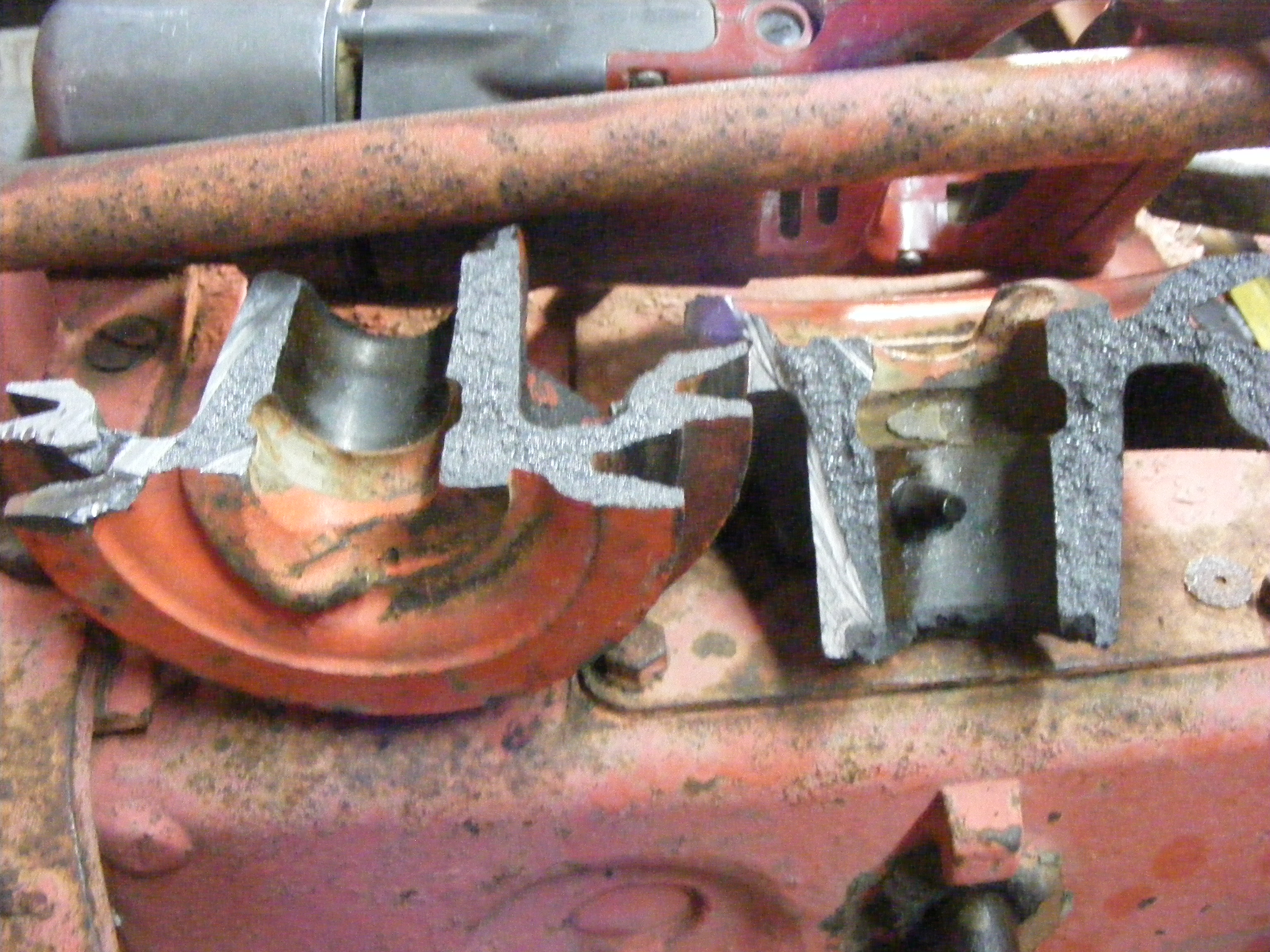

Posted By: hamman01
Date Posted: 28 Jun 2012 at 8:10am
Not much progress on the pulley. New roof on house and Dr. appts. have kept me away from the garage. With the temp being in the 90s + that hasn't helped either. Hoping that after Saturday I can get back on it. I have been plotting a course of action to get the pulley off. I have tried to think of a way to save it but that hasn't happened yet. I believe if I use a 6" angle grinder with a thin cutting wheel and cut on both sides of the pulley and then use a sharp chisel striking it sharply should make it crack and come apart from around the crank. ( Thats what I dreamed in my perfect dream)
Posted By: hamman01
Date Posted: 19 Jul 2012 at 8:59pm
Finally got the pully off tonight. My BIL who is a mechanic came over and with my Porter Cable and Milwaukee Sawzalls cut a slot in the top of the pulley enough to drive a chisel down into it and darned if he didn't split that pulley in half. As I had said before I had drilled as far as I could. After getting the pulley off I can see where I had drilled into the cranl. It appears though that it did not hurt the hole for the bolt enought to worry about it. I do see a lot of shavings and saw (cast) dust in the hole in the crank. I am going to use a small powerful vaccum to suck the shavings and dust out. I am afraid if I used air it would push it into the crank and possibly out into the bearings. I will try to post some pics of the finished product. Thanks for all you help and if you have any other suggestions for me feel free to say so. thanks again.
