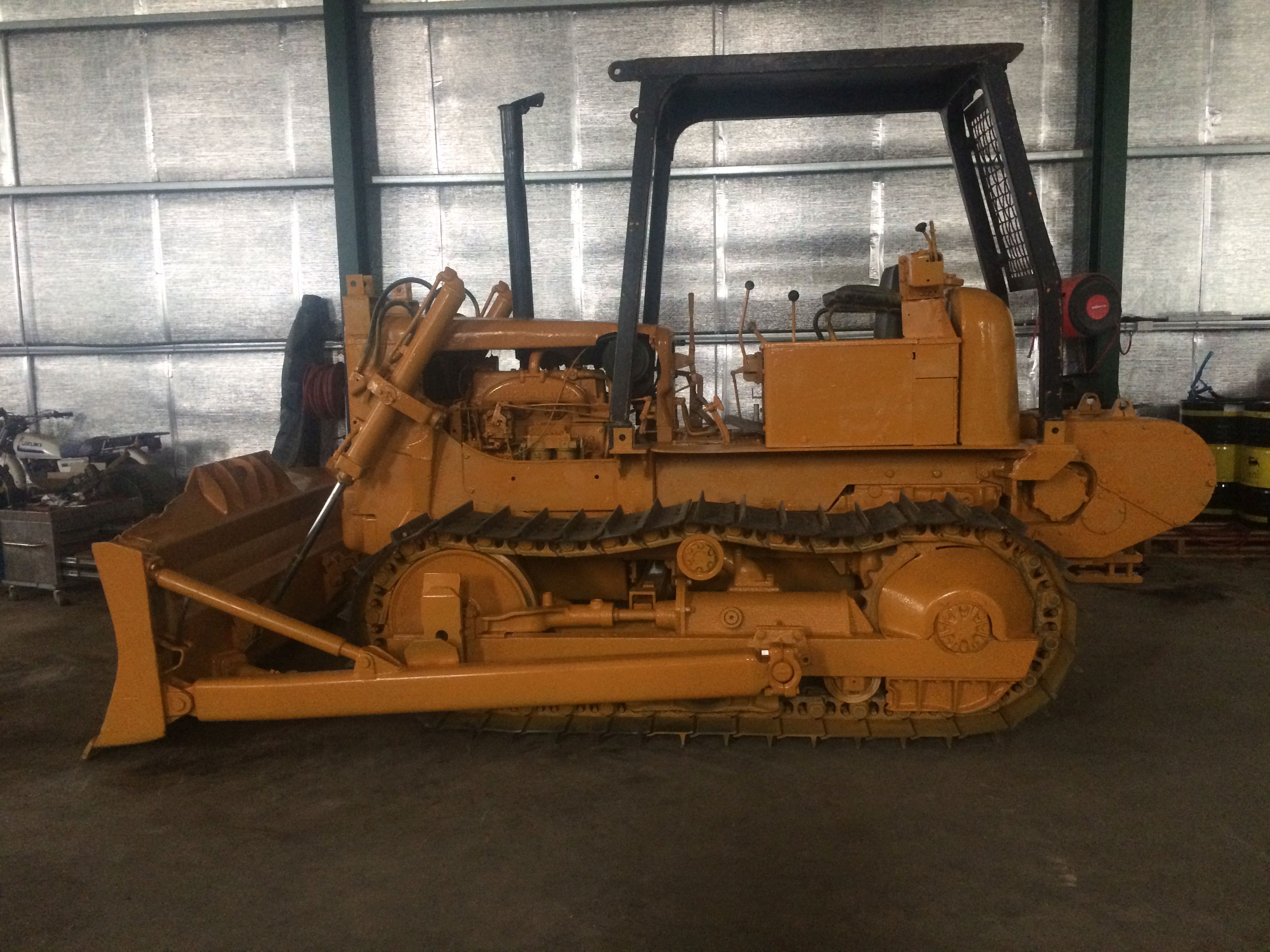

A mate in australia, Warren Lucas has probably the biggest fleet of HD6EP in the world ! about 5 of them, 1 imported from NZ and rest from Missouri USA
Another USA collector Rick Vosika from missouri has a couple of HD6EP in his collection of about 14 HD6s, amongst everything from HD3 to HD41.
Pic of a HD6EP he imported to Oz from Missouri

Resized Merv:

I would say the tractor looks pretty much like this last photo. Only picture I have was inside a barn, dark, and taken from a distance so no resolution. Definitely the same style straight push blade however.

Forgot to say; that tractor in pic from Missouri, had been dealer turbocharged.
 Incidentaly Rick Vosika the AC collector from Missouri also knew about that tractor as it originally belonged to a mate of his.  He later found out it had gone to australia, and coincidentaly I knew exactly where it had gone too !

What do they use for a power steering unit? it looks like some thing that would go nicely on my 11.

HD6 steering pump and valve was same as used on early wet backend HD11E and 11EP; s/n 10000 to 12200
