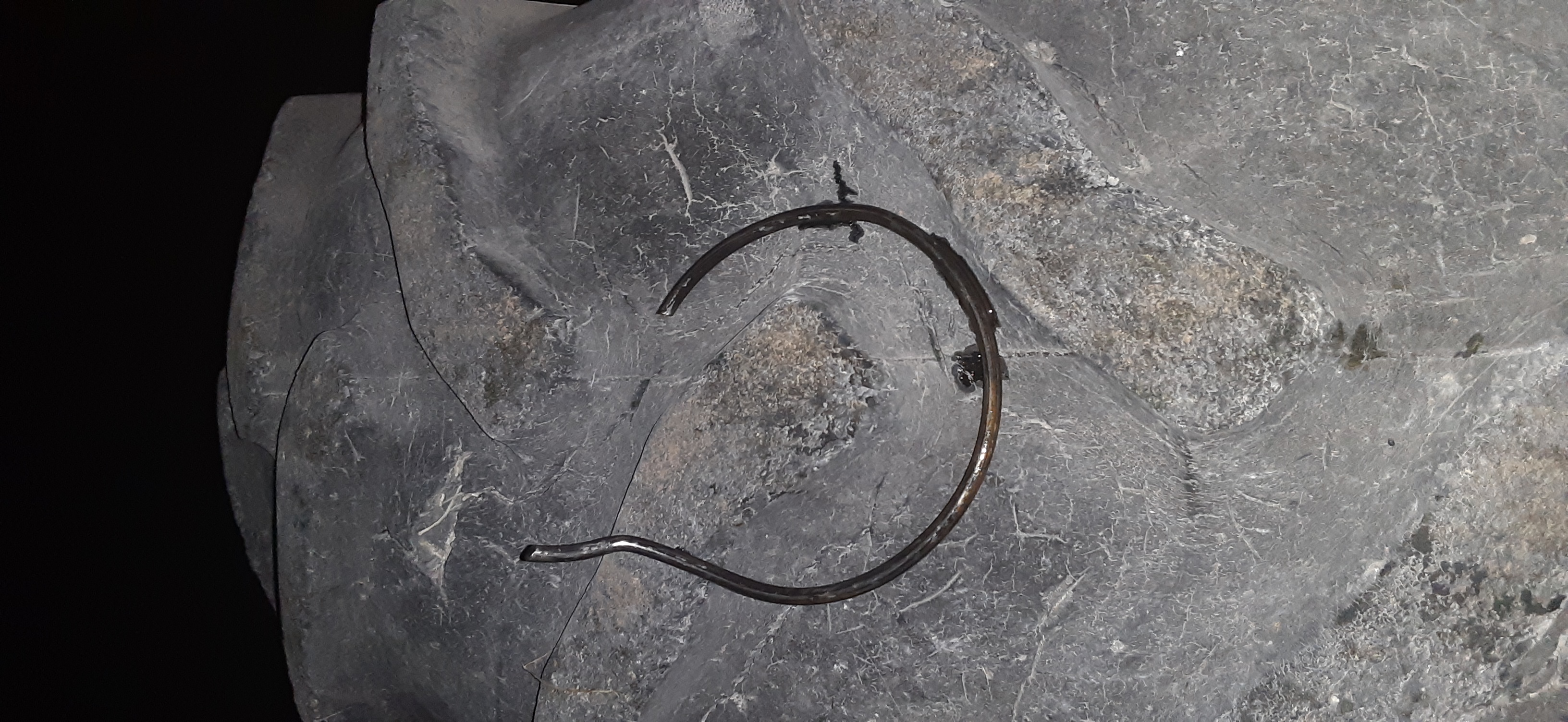

Awhile ago when I was working on it I found a ring in the bottom of the clutch housing
Posted By: DrAllis
Date Posted: 01 May 2024 at 8:22am
That would have been helpful to know. A 3 inch diameter piece of wire ????????

Posted By: hunter321
Date Posted: 01 May 2024 at 9:16am
this is what I found
Posted By: DrAllis
Date Posted: 01 May 2024 at 10:07am
From the hand clutch itself. That keeps the pressure plate contained which allows for a NEUTRAL/ disengaged position of the clutch plates/discs. That one is junk. I doubt that a new one can be had from AGCO. If you found a good used one you might be able to worm in into place in-chassis when the hand clutch fully engaged exposing the groove that wire fits into.
Date Posted: 01 May 2024 at 10:10am
What is it called so I can attempt to locate a new one

Posted By: SteveM C/IL
Date Posted: 01 May 2024 at 10:37am
That is the snap ring that holds clutch together. It's bent . Should be a perfect circle. Your clutch cannot function properly . There was no "snap" in the clutch like that. You were asked about the "snap".

Do you guys have any advice on how to bend the snap ring into the correct shape on the hand clutch once I get it out of the tractor so it fits perfectly so I don't need to weld it in place

How do I bend the snap ring in the right shape.
Posted By: mdm1
Date Posted: 04 May 2024 at 4:17pm
Click on the link I have posted. Click on the WD-45 section. There will be illustrated diagrams of the parts by section. Search through it. Also do a web search for WD-45 torque tube. lots of pics out there. Hope the link works https://parts.agcocorp.com/us/en/apbsearch/model" rel="nofollow - https://parts.agcocorp.com/us/en/apbsearch/model
