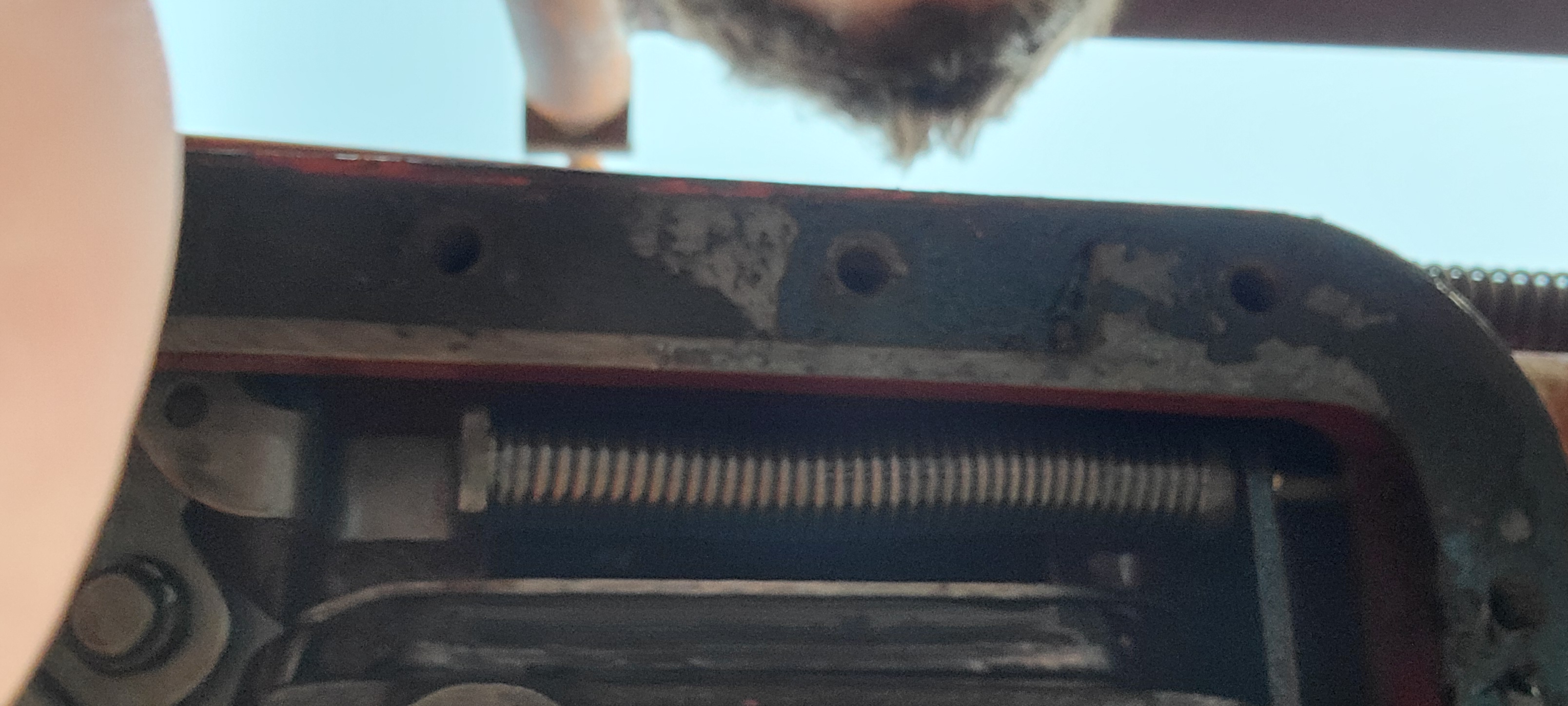

Posted By: MadCow
Date Posted: 22 Apr 2024 at 8:31pm
You can just see the brass nail I used, and where I disconnected the linkage.
Posted By: DrAllis
Date Posted: 23 Apr 2024 at 2:11pm
You've got the nail on the wrong side of the bracket the rod slides thru.
